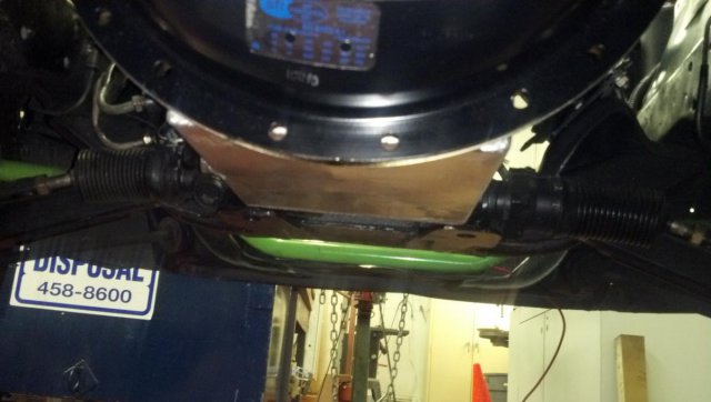

i worried about that too. my 280zx had some tranny tunnel reinforcement but didnt feel that did too much. so i added some 1/4in thick steel plate to the floor. had it welded to that tranny support, then welded it to the frame rail. that gave me some great rigidity and i no longer worried about it. not a great pic cause they are painted black already in this pic and they blend in with the bottom of the car. -
