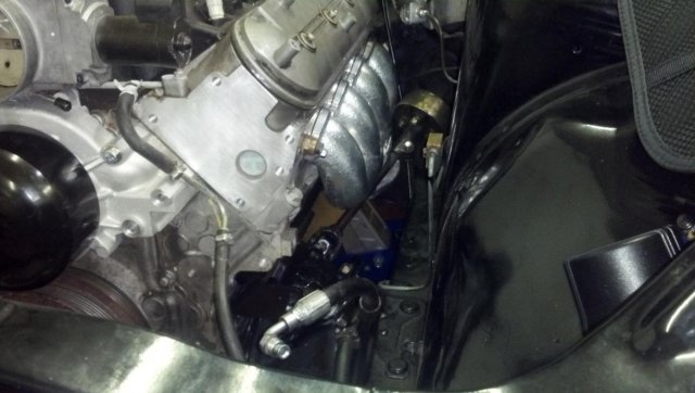

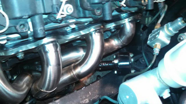

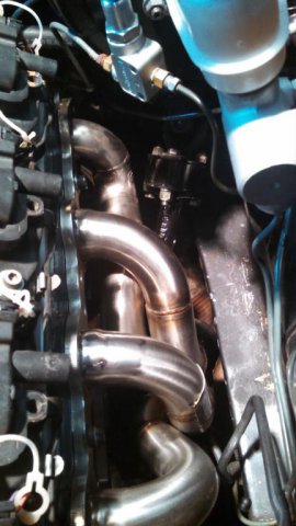

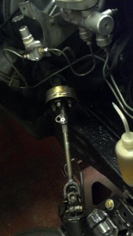

  2. sorry for the extra post here but the pic of my steering shaft shows that I drilled and tapped threw it to put a screw threw it then what the picture doesn't show is that it allowed me to cut that ear off so that I had more clearance. there is pics of 2 different options for headers, both of which still had to be modified before they would fit. I also made a solid aluminum spacer to get rid of the rubber piece on the shaft. I made it smaller diameter than the rubber piece for more spacing.

  6. the 280zx doesn't seem to get any attention from parts manufactures when it comes to LS swaps. it took a lot of work to get mine done and I know who ever else has it done had to do the same. im just curious to see how many are out there and id love to see the different things people have done to get past certain road blocks such as mounts and headers. I know I had a lot of issues with mounts and oil pans and especially headers. if I can help with any issues I am more than happy to share my build. I modified JTR motor and trans mounts for a SBC to work with my LS. I used a stupid expensive oil pan from canton to get the motor low enuff. it has a very shallow front sump to clear the pwr steering rack. headers I originally used a manifold on driver side and block hugger on pass. side. now I have Billy Boat shorty headers for a c5 that I still had to modify. again, please post yours. how many of us are there?

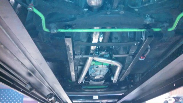

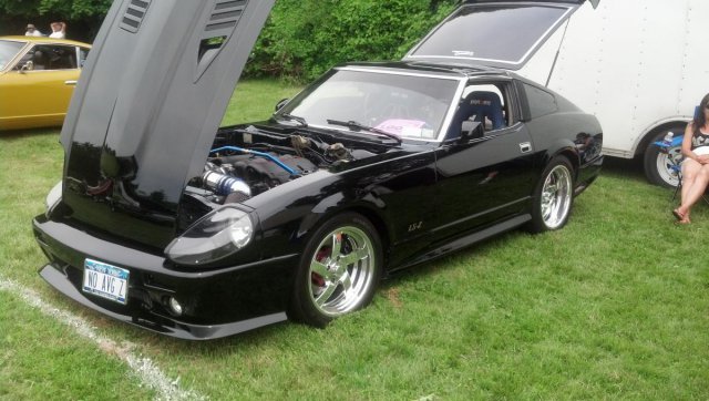

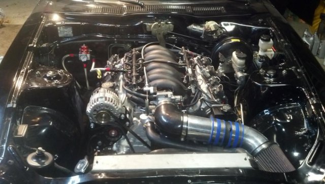

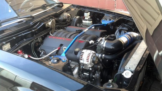

  8. :1983 280zx :L33 5.3 aluminum block bored to 5.7, ls2 dart heads, forged piston/rods,ls6 intake 406whp :RPM t56 trans rated for 750hp :R200 w/ 3:54 gears and quaife internals :modified JTR mounts for SBC to work with the Ls motor :special Canton oil pan to get the motor low enuff :headers are the biggest problem, I modified Billy boat c5 shorty headers :made my own dual 2 1/2 to single 3 1/2, all stainless, had to use oval pipe to get over sub frame :my grandfather purchased the car in 1984, then my dad had it and I bought it from him in 2004 started with a SBC swap in 2008 but it made the car nose heavy and I still felt it was out dated. in 2010 the Ls swap was done.im jealous of all the stuff the older Z's have for Ls swaps, zx's have nothing : A friend and I fully restored the body and painted the car from blue to black :Arizona z car brakes :techno toys front shortened coilovers :custom made 420lb rear springs (very needed to reduce squat) :whitehead performance 300m 39 spline stub axles :300zxt cv-joints :Boze custom made rims 17x7 and 17x8 :shaved side markers, antenna, side trim, rear wiper, custom taillights :aeromotive fuel system, modified gas tank to be gravity feed. : on and on and on, ill just stop there everything done by myself and help from friends and family. many,many long nights and dedicated hours. And a wife that supports me taking the time to do it. BUILT NOT BOUGHT!!!
