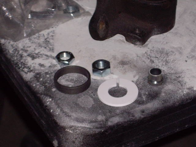

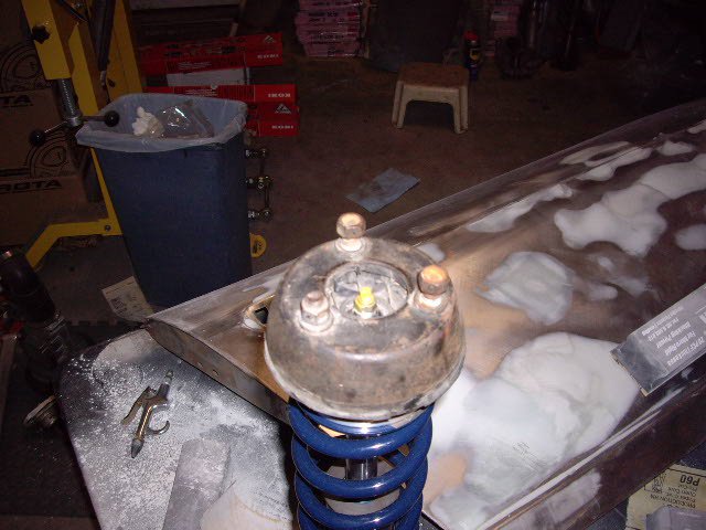

Hey guys, I am putting together the coilovers for my 260z. I am using Koni race shocks and hypercoil springs. I am using the stock rubber insulators for now, but I have a question about assembly. Here are some pictures. So, I put on the springs, aluminum spring perch that came with the threaded sleeves, then stock insulator. Does that sound right? The Konis also cam with the extra parts in one of the pics, nuts, metal ring, plastic washer, and some kind of bushing/ sleeve. Not sure where the bushing/ sleeve and plastic washer goes. If anyone can enlighten me it would be a great help.

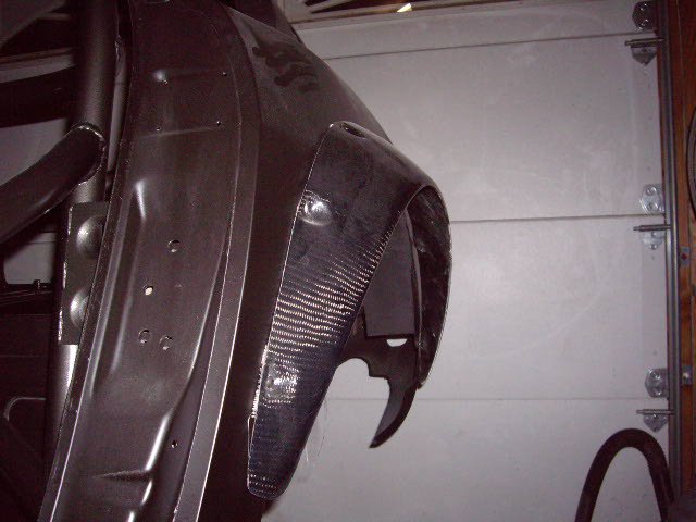

So, some people were askin to see more pics of the flares. I still need to put some rubber around the edges to fill the gaps. These are extended ZG flares that I got from a past member, zforce, most know who he is. Enjoy.

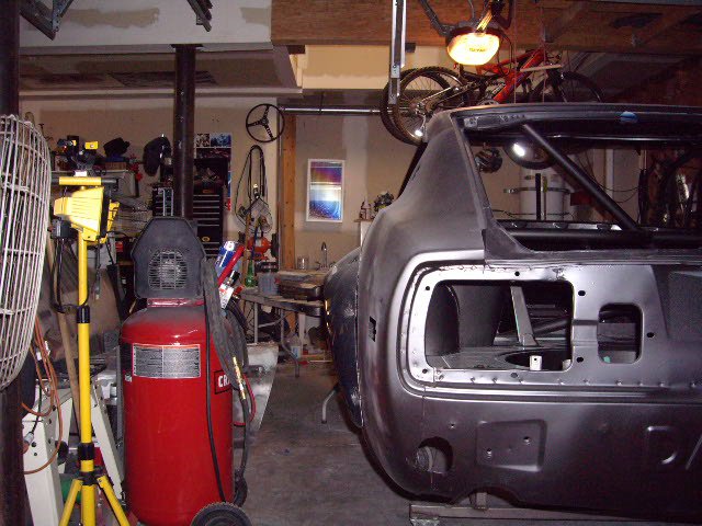

Okay the pics that I have from my build are on the large side and I guess I am limited on space on this forum. So I set up some links to my photo bucket album. Let me tell you a bit about the project. This is a 74 260z (early) that I bought 3 years ago for $1,700 in Moreno Valley CA. I started taking the car apart with no intension of doing a full restoration, but that is what ended up happening. Anyway long story short, found rust, had to fix it. I have so far done 100% of the work myself, never done it before, and I am still flying by the seat of my pants. All the knowledge I have gained from this project have been from the terrific people on this forum. Any questions feel free to ask and I will try to answer the best I can. Sorry some of the images are out of sequence, but you can still get the jist. original engine the beginning the beginning patch panel patch panel sub frame connectors patch panel patch panel patch panel patch panel patch panel patch panel rust rust another patch under coating on rotisserie new engine frame rails rotisserie engine frame rails My link My link My link My link My link My link My link My link My link My link My link My link My link My link My link My link My link My link My link My link My link My link My link My link My link
