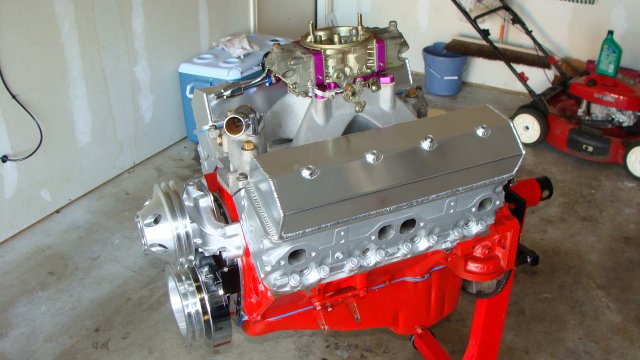

  6. this is the newest addition to the z to be put in next weekend.just waiting on the tranny to get back. .60 350 vortec heads big valves light bowl job, LT-1 cam with 1.6 rockers,forged flat top,scat rods,hurricane intake,proform 850 dbp,and 150 shot. should run fair in the z32 3100lbs.
