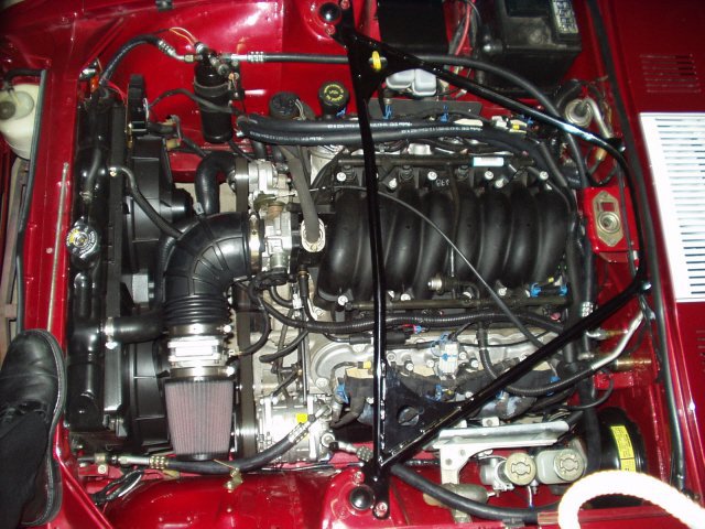

We used the John's cars compressor kit. We also had the LS1 Wire diet guys do the wiring of the computer. If they are not listed above I have the receipt, found them on eBay. There is an AC request on all LS1 computers as far as I know. We sent the Vintage air 12 volts to that, used the trinary switch from the GTO to talk to the computer. The computer then sends a 12 v signal to the Under hood fuse panel that has a relay. We just put a relay on the fender by the compressor with 12V from the battery. Works fine. We did have to get a fitting and TIG in the trinary switch though. Used the one from the GTO and used an in line port fitting. The advantage is the computer runs the AC, WOT cut out, under or over pressure, over 40 MPH no fan, over 4000 RPM cut off. Lots of good stuff happens. GM engineers are a lot better at this stuff than we are. This may help on the pin out info. Fortunately my 280Z already had factory AC when JCI was developing their components on it so it was just a matter of making the compressor fit and then work with the Datsun controls. -

The Broken Kitty (JCI) kit was developed on my car back in 2002/3. I have been driving the car for 16 years and about 45,000 miles and have had 0 issues with any of the JCI components. They may not be as sexy as some of the other kits but they are time proven. They also mount the LS motor in the ideal location for the T56 shifter to come up through the stock hole on an S30. I think it is also the most complete source of components. Engine and transmission mounts, driveshaft, radiator, tach conversion, AC compressor if you want one, and fuel pump. All the components were engineered to work together and to be relatively easy to install. The red 280Z is the car that JCI developed their components on. The gray 240Z is the car that Grenade300 did his photo how to thread for the JCI components. It is now owned by my son, DarthZ. -
