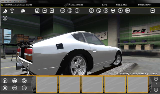

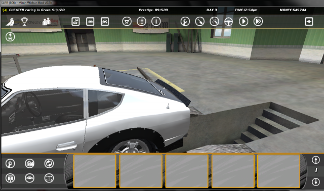

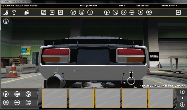

What do you guys think about this. I was thinking about making this out of carbon fiber and some adjustable links. In the pictures it shows that the wing does not fit the whole car, I was thinking about making it go all the way to the edge of the body.

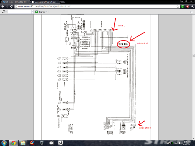

I figured out the problem. It was pin #1 on my harness. It was not connected to the(-) side of the coil, which controls injectors opening and closing. I wired it up. Started right up. Has a little trouble revving, and initial warm up. But idles great. And when I say trouble revving, it feels like it is taking its sweet time to rev. I havnt driven it yet to get an accurate test. It needs breaks first. Hopefully it just needs a little breaking in. -

UPDATE!!!: Today I got my car running. Sorta I found out that the pin #1 was not even connected to the (-) coil side. So I ran a jumper wire from pin 1 to the (-) coil. Plugged everything back in started the car and it ran. But didnt want to rev. Thats okay right now im just glad I found the problem. But, while the car was idling I reved it a few times... Or tried to, and then one of the fusible links blew. If your standing on the passenger side of the car looking at the 2 fusible link holders, its the one on the right closest to you. Which link is this and why would it have blown? Also is there supposed to be a resistor between the pin #1 and the (-) coil? And the absence of one caused the fusible link to blow?

Update: test #1: I did the ignition coil trigger imput circuit test from the efi bible, I tested pin #1. Its supposed to read 12v on the on position. It read 0. Test #2: I also did the control unit power input circuit test. testing pin 10 for 12v. and that test i got 12v. So, what does my first test tell me? Why wouldn't pin #1 be getting 12v?
I was wondering how the ignition coil controls the firing of the fuel injectors. When I looked at how the coil was wired it didn't look like it went to the ecu harness at all. Just from the distributor. And a + and - If someone could explain it to me that would be nice. And I do have the owners manual, The FSM. and the efi bible. I've looked through but all I could find was what pins to test with the volt meter. Did I miss something?
UPDATE: I took a Volt Meter the the injector harness and I put the + to one pin on the harness, and the negative to a ground Bolt on the fire wall. When in the "on" position it had 12v. I checked every injector plug. They all gave me 12v. But when I put the + in one and the - in the other pin and cranked the motor I had 0 voltage. So with my basic knowledge of how injectors fire, I have no ground to the injectors switching them open. Where could I have a bad ground at causing the injectors to not fire? I read that the negative on the coil controls the ground on the injectors. Is this true? And also, I read that the problem could be my Fuel injection relay mounted under the driver side dash. The injection relay controls the 12v feed and the fuel pump turning on right? (My pump turns on when I push the flap in the AFM) So if I have 12v going to the injector it cant be the relay correct?

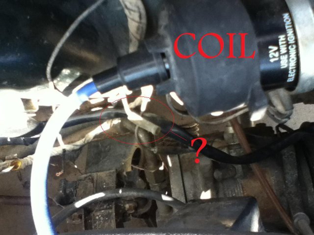

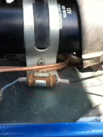

Well the blue wire on the capaciter goes into the wiring harness. Im guessing black is ground. There is a chewed up ground wire by the distributor. I'll solder some wire and put a bolt connector on the end. Anyone else know about the bullet connector wire?
I Have a problem with a couple wires that I dont know where they go. There is a black wire coming off a resistor next to the ignition coil that has been chewed up and I dont know where it goes. Also there is a female bullet style connector that does not have its counterpart. I was hoping you guys could help me figure this out.
