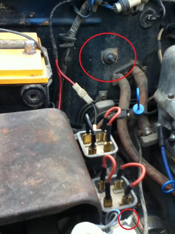

In the process of replacing hoses and vacuum lines I found this, (Big red circle) It's a cut hose coming from the fire wall on the passenger side. upon closer examination I found a piece of hose on the frame rail and it looks like it was from the fire wall. The little red circle is a male to male plastic hose connector. I was wondering if that hose connected to the one on the fire wall. Any help is greatly appreciated.
