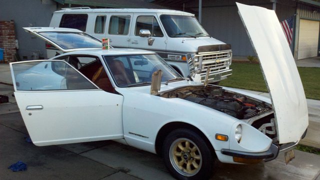

  22. sorry people forgot to show you my car im building...like them plates ????? take a look at whats on the roof in the pic with the doors open....its an old can "sealed still" of gtx 20-40..found in rear cubbies...

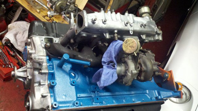

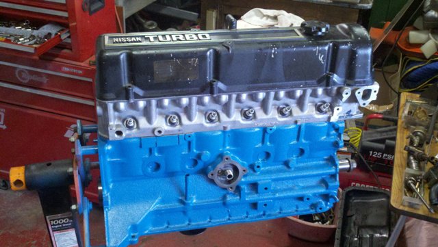

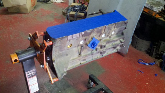

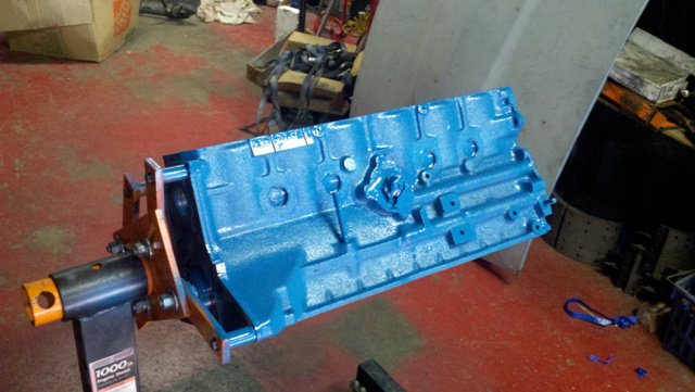

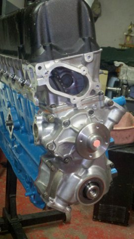

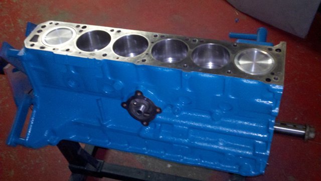

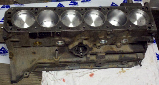

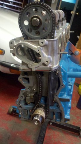

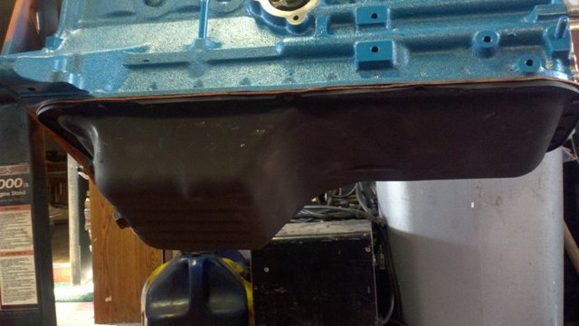

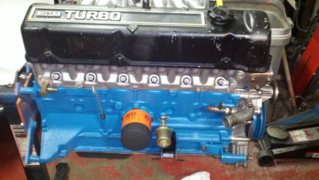

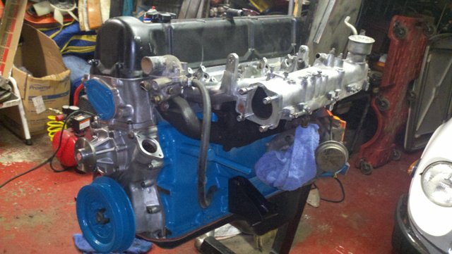

  23. ok....i think i got the picture thing all figured out soory for that...updates on the build im moving right along..got the timeing kit installed front cover waterpump manafolds thermastat turbo and oil pan along with some other small thing like oil pump and cooling accs. heres some pics from previous posts..and current ..enjoy!
  24. Nice build bud did you get all the edis stuff off that same ford
