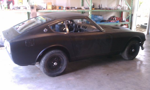

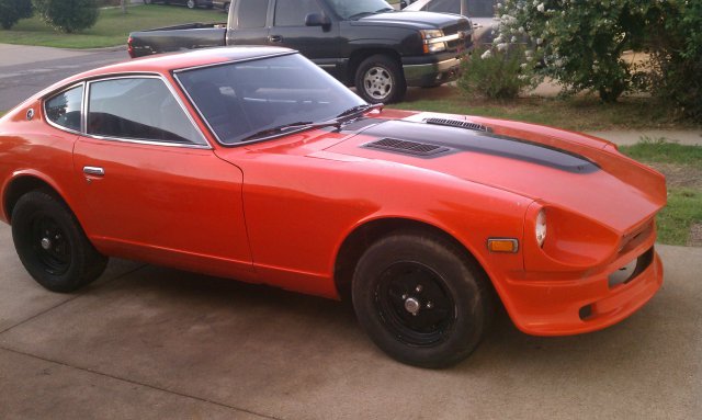

  4. Also already got some stickys on there but i had to run 1.5" spacer to make them fit. Thats what happens when you buy the wheels with the wrong offset. Drove it around a bit today definately an improvement from the constant spinning it had before.

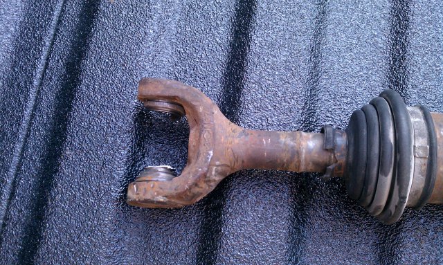

  8. No I replaced all the u joints before this happened they have maybe 400 miles on them gotta love warranties. Im pretty sure Im done with the independent rear from what I can tell its just too much money to make it hold the power. A solid axle is a lot cheaper and stronger should do everything I need it to do.
  9. From what I can tell it broke in the middle but we are talking about a second or so could be wrong. I was dumping it at 2k and was getting 2.0 60ft. I have stickys on it now but if it breaks u joints with street tires theres no way it will hold together with stickys. These tires are 275 50 15 so plenty of tread.

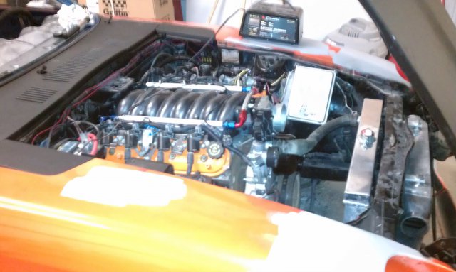

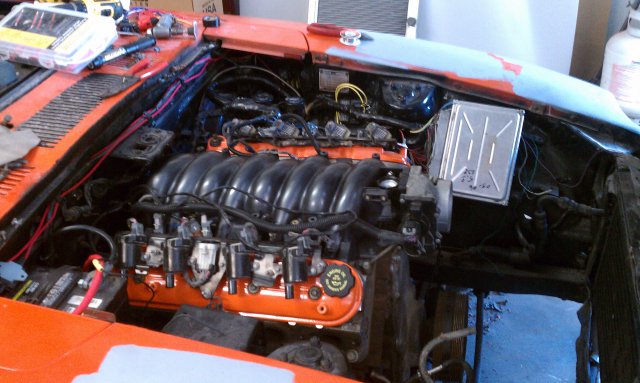

  10. The steering shaft is in the way i used c6 manifolds and had to smash the pipe to make it fit. But i plan on doing a turbo so the steering shaft wont be a problem at that point.
  11. Im seriously considering doing a 9" or 8.8 with a 4 link and coil overs. I got about 6 passes out of it on street tires 245 60 14. Best was a 13.84 but i had to let off when i hit second because of wheel hop. Then I had to let out again the 1000ft mark because of wheel hop again. So if it hooked up and I could have stayed in it its probably a high 12 to low 13 car. The u joint snapped about half way through 2nd gear.

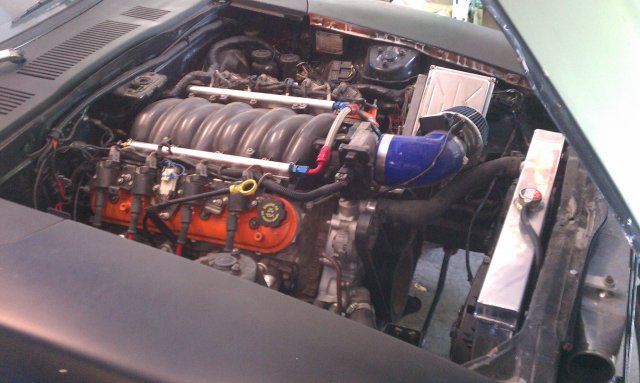

  12. i centered mine in the engine bay. I measured from the center of the crank pulley to the frame rail.

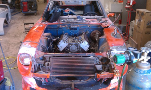

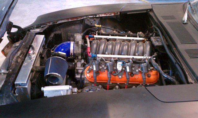

  14. So i started building this car about 4 months ago. Got it on the street roughly a month ago. It is a 5.3 with drive by wire and a mild cam. Trans is a t56. The diff is the stock r200 with welded gears. Decided to go the track yesterday and found out why everyone says go to the z31 axles.

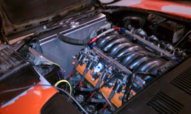

  16. I welded my mounts straight to the frame rail on my 5.3 swap. Works fine so far car is weighing in at 2700lbs.
