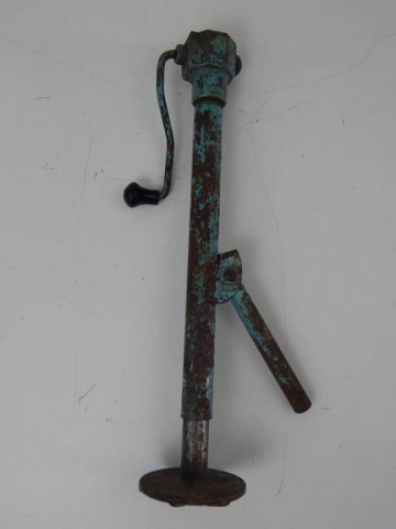

  14. What kind of jack do you all use? I've got the standard Zed scissor jack, and I'm wondering if it would cause damage to the bottom on the fiberglass rocker? I suppose I could glue on a shallow piece of channel in the four places where you'd put the jack. I think some kind of hard rubber would be better. Both metal or hard rubber channel could be manufactured, then attached with glue or fasteners. But faux jack hole covers for the antique Riganti jack would be a nice touch. Here is a Riganti jack and a jack hole plug. I'm surprised no one was killed using those jacks.

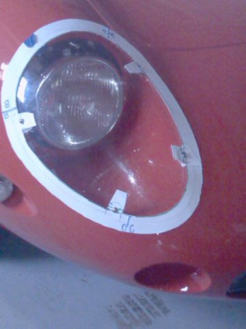

  15. Those headlamp rings look nice. Are they metal? Do you make them yourself? I'm working on some now.

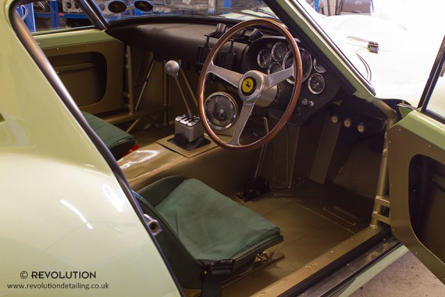

  18. "I had never seen the interior of this one!! Thanks for sharing!!" The Moss car is probably the best example of how the cars looked when they were leaving the factory. They were simple, with no luxury, except for the demisting nozzles. To save weight, they even left of the door panel finishers, carpeting, ant most everything else. I think if you took it to a "car show" I'll bet people will get (offended) by how there is no 'interior' and the simple aluminium seats would be called "crappy seats" because they are not carbon fiber, with leather and not labeled Recaro. The lack of carpeting, door panels, and the visible tubes of the frame are just too simple for anyone not thoroughly educated on the design. Just in case, go here to see the photos.

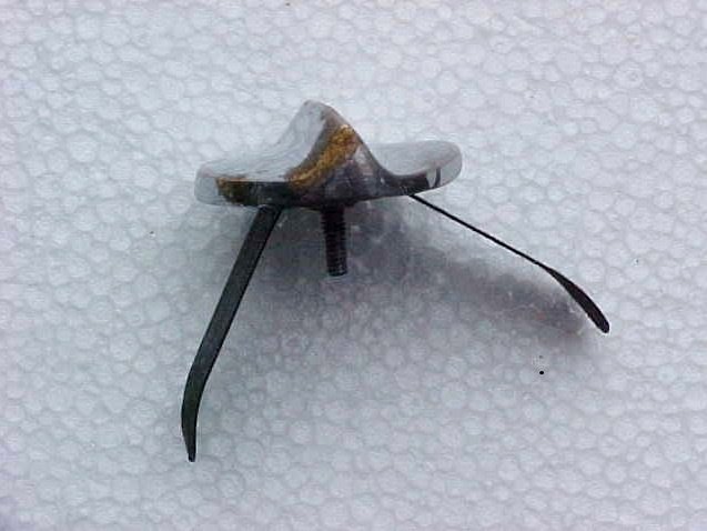

  20. There's no need to plate the stainless steel rings. You can simply polish them. OTOH, I'm not sure that you can make the trim rings and put them on any car, because there is no spec for attaching the headlamp covers. People put the little brackets where ever they please, and it seems like they are place in about the same place on each side, it's not a perfect mirror-image. Having made some templates from posterboard, I tried it on my car, and even though the shape will do, the screw holes don't match, so I will have to make them individually, but only place the tabs for the screw holes in the right places on each.

  23. If you offered a set to me for free, I would turn you down. The reason is that these cars were just not that fancy, there was no ventilation fan, rear-window defogger, not even carpet on the floor, except for a few exceptions by the private owners. I've looked at photos of the door doors, and they were either plain, or bare- no metal at all; all you could see was the frame which is otherwise covered. on street cars. You need to stay with your goal of building a GT car or a race car. The race cars were bare-bones vehicles, but the GT car were sometimes afforded a bit of car or the diamond-pattern vinyl on the transmission tunnel. If you really wanted to put something there, I'd suggest just a flat piece of metal, cut from a sheet, (not bent, like the Datsun piece is) with the script OR the logo (be careful of putting the word FERRARI on it, unless you like lawsuits, but the Cavallino speaks lots.) a brushed texture would be plenty of 'fancy.' This photo is of the Sir Stirling Moss car:
