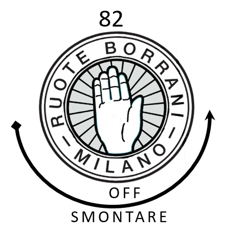

Speaking of the Dayton wheels, the wheel nut/spinner is plain without any engraving; like a Boranni logo & removal-arrow. Has anyone managed to do any engraving (I think they were stamped before being chrome-plated) or anything else? Instead of grinding the chrome off, then engraving, and re-chroming the nut, I was thinking of other means to duplicate the effect. One idea was to have some medallions or "coins" made with the graphic (two different graphics are needed because the arrow is reversed on one side) and then glue the things to the nut. Perhaps a trophy shop could do that? I know the Dayton nut/spinner has a removal arrow on it already, so you'll at least need the Boranni logo (the open hand with rays of light.) I still need to get the graphic right, because the curved arrow with a fancy tail is not standard to most graphic design softwares. I think what I would do is to have the design put on an aluminium "coin" or disc and glue the disc to the wheel nut/spinner. It's just too much trouble to de-chrome, engrave, and re-chrome the thing. What do you think of this design? I put together a few shapes using MS PowerPoint: New wheels!

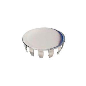

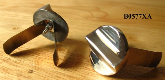

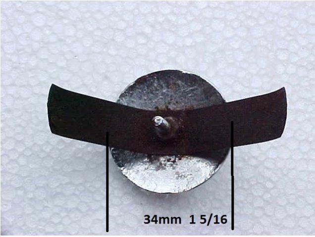

I am working on the smaller items right now. The current item is the covers for the jack holes, or "sill hole covers" (1st & 2nd photos.) They remind me of the knob on a stove control panel. There are many options you could choose. Some people have chosen to use ordinary covers used on your kitchen sink (3rd & 4th photo) but (3rd photo- my selection, but a solid top.) Maybe someone here might have a mold &mini-foundry to make up sand-cast aluminium slugs that could be finished by ourselves (First photo. You could even use a cheap plastic hole cover Please review the attached photos.
OK, you can add to the list of little bits, a set of plugs for the jack holes. When I was researching these or how to make some, I read that some people chose to use the round, chromed plugs you put in the hole where your facet used to be (a sink hole cover.) The jack hole cover:

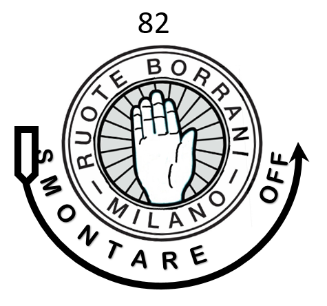

Higuys, I'm having a hard time trying to come up with an accurate graphic for the Boranni logo with the directional arrow, so I can get the knock offs engraved. Does anyone have a graphic they can offer? I have the hand graphic and the rays with the letting done using MS PowerPoint, but there is no way to come up wi the curved arrow that has the right kind of 'fletching.' Here is what I have so far: My condolences and sympathies go to Alex in this time of difficulty. My car is really fun or a pleasure to drive, even with my finely tuned L28, and I can relate to his dilemmma. BUut... I think all the gawkers finally stopped bugging me with "is this a real one?", so the real admirer's can have a voice

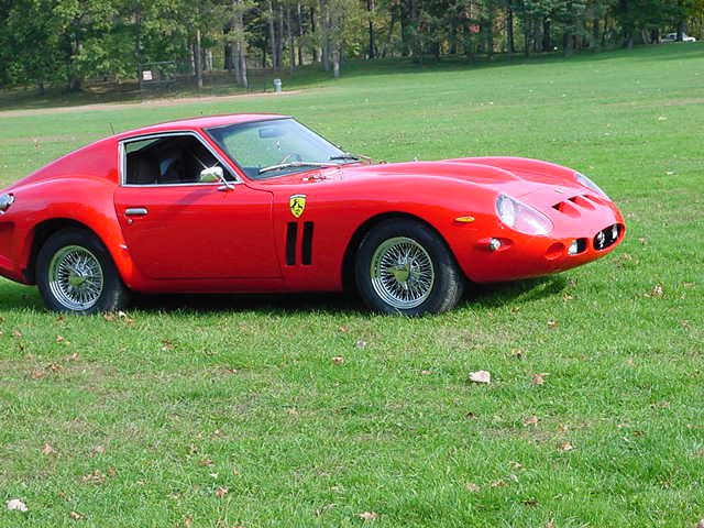

John- The car left the body shop last July. I still need to do a few things, like mount the fog lamps, get some trim rings, and get the new wheels, but I get to use it, and most people seem to think it's a "real car" whatever that means. I sometimes get some mixed results (I hide a digital voice recorder inside at cruises & shows.) One guy said it was just a kit car with a Ferrari shift knob and steering wheel, and another called the Eclipse seats "crappy seats" even though they were like-new. One guy cursed it because "it's not supposed to have carpet, those aren't racing seats, the gauges are wrong" and then started knocking on the body, until a friend chased him away. For sure, if I wanted to make it really authentic, I'd have to strip out all the carpet, plastic, door and interior panels, paint the inside aluminium and lighten it another 500 LBs., but it's a GT car,"Lusso-style" and I built it as well as the wallet and circumstances allowed. The real car enthusiasts think it's wonderful. Enjoy ===> http://s955.photobucket.com/user/TomL_CleOH/library/Park%20Photos?sort=3&page=1 ==> http://s955.photobucket.com/user/TomL_CleOH/library/Paint%20Shop_After?sort=3&page=1
