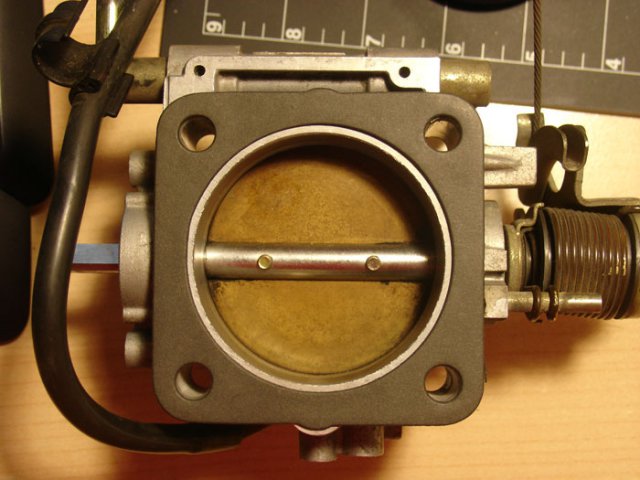

  2. I bought a 1988 240sx throttle body at the yard, pretty sure it's a 60mm it measures around 2.36inches. I bought the TB gasket for a 1989-1995KA24DE engine, but does this look right to you? The gasket hole is bigger. Check out pic. I intended to use the gasket to outline and port out my N42 intake.

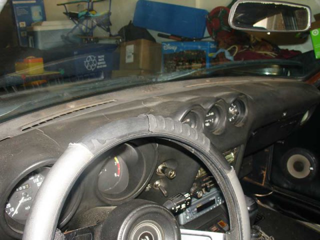

    My dash was cracked pretty bad. I just cut the parts that formed an uneven surface and I didn't fill the cracks with anything. I probably could of used that product called "Great Stuff". It's a spray on foam that dries hard filling the cracks. I did paint the bottom portion of the dash with black vinyl interior paint. Although you can't really see it, it still made it look waaay better than before. If you are interested in repairing your current dash and not use a dash cap, you must follow this link: http://classiczcars.com/forums/showthread.php?t=23919&highlight=dash+repair I also used alligator clips all around once I glued the dash cap on. They are pretty cheap at harbor freight. I left it over night to dry. I used a motorsports full dash cap. It was like 89 bucks when I bought it like 11 months ago. Attached is a picture of my cracked dash.

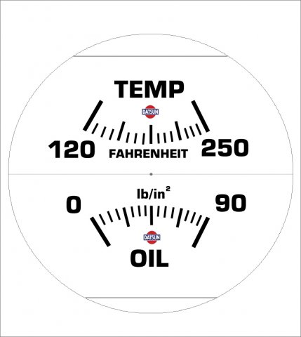

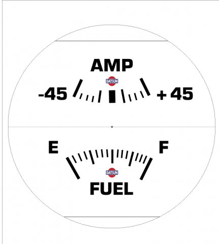

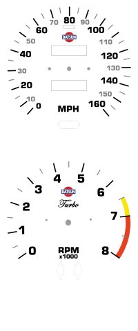

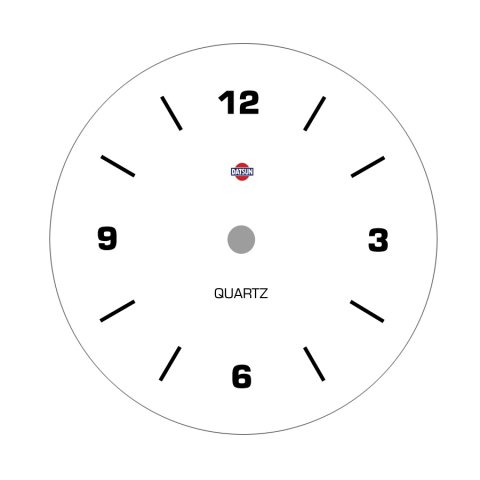

    I made them myself. Photoshop, photopaper, and glue spray. I have the image templates if anyone wants them.

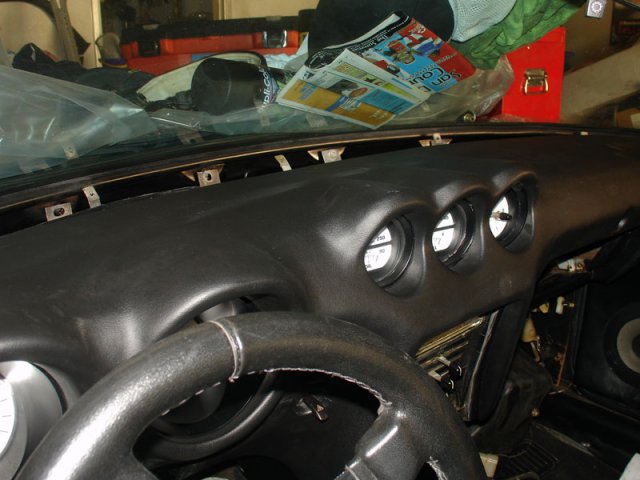

    Here are a few pics. I plugged all the electrical stuff back in but I screwed up the position of the leds behind the tach and speedometer. The right signal arrow stays lit when I turn the key. When I activate the right directional light the entire gauge blinks, doh! Same with the high beam. The blue slit in the speedometer stays on and when I hit the highbeam switch the entire gauge get's brighter. I really hope I can fit my hand from under the dash to switch the bulb plugs!

    I'll take some tonight. edit: My camera needed charging...tonight pictures for sure. Overall, it looks great compared to the old cracked dash. I designed the white faces with Photoshop, nothing crazy. I added the Datsun logo to all gauges and put the word "turbo" on the RPM gauge. I used photo paper to print and a circle cutter thing to for making nicer cuts (not perfect). I did end up scratching the cap in a few places during the three times I had to install and uninstall.

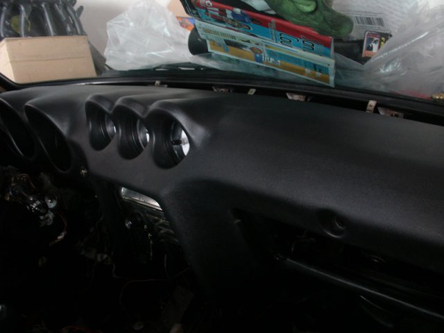

    So I redid my dash with the full cap, and also installed white custom overlays on the gauges. Yes, it was all a pain in the butt and more so now that I routed the wiring incorrectly and have to take off the dash again. The center air/temp controller console is so annoyingly in the way. Sorry guys, just venting a little. I'll post some pics when it's done and in place again. 72 240z.
