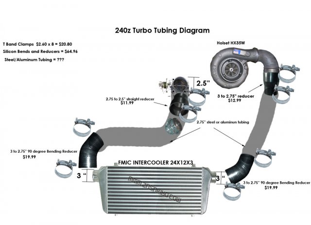

Yep, it's 3". Thanks for the advice. The only reason I really had it at 2.75" was to be sure I would have enough space in case things got busy in that area. So the 2.75in on the intake site is fine? Thank you all for the input.
Okay, here's what I'm thinking I will need for making my Hx35W turbo work with my IC... am I missing something? Is the 2.75 inch diameter ok? Also, anyone deal with siliconeintakes.com?

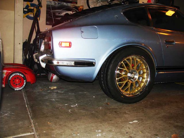

Finally got tires of my rear rims. Suspension: Tokico Blue Struts with Eibach Springs. Tires: Yokohama S drives - 245/45/17 Rims: Adven Siena's Gen II 17x8.5 rears 17x7.5 fronts I only installed one rear wheel for a trial fit. -

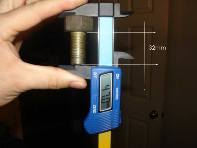

Okay, here are pictures with the timing mark noted. Also, the thread length on the crank screw measured 32mm. Let me know if you need any more measurements. Alex
