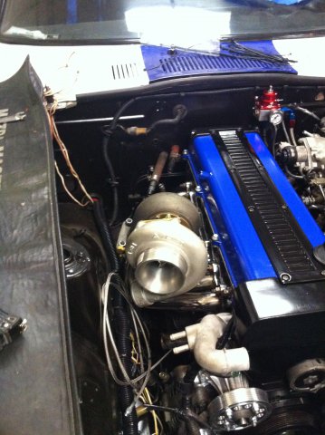

  2. Ok, I got alot done today, it's running . I'm going to get the driveshaft built this week. So far this has been a pretty easy swap. It's alittle harder than a rb swap but all around this is Cake.
  3. I took a little time off from this project and now I'm back on it. I've ordered everything else I needed and I'll have it running very soon. I'm going to build the exhaust this weekend ( I hope lol). I got 3 inch stainless from the turbo back. I'm going to tig weld it together.

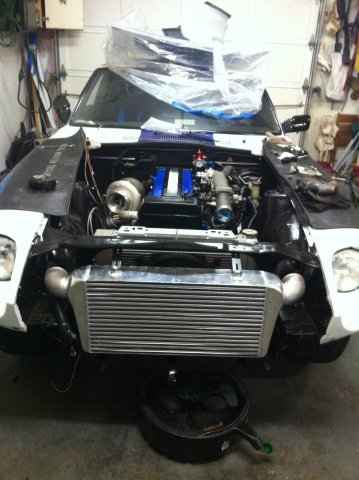

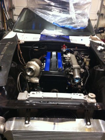

  14. I got sometime today to work on my Z I picked up a different turbo a precision PT-61 I ran all my fuel lines from my fuel cell and installed a aeromotive fuel pressure regulator.I installed the engine and trans.

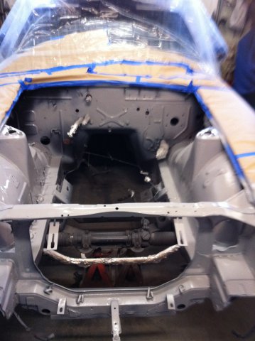

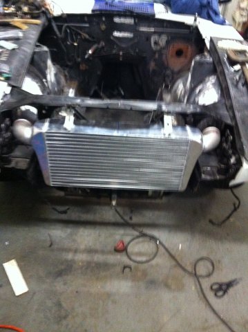

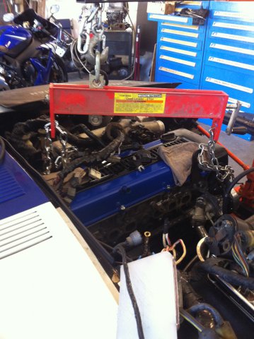

  15. I been so busy building rear sump oil pans for the RB guys. I finally got some time to do my project I finished the motor mounts and welded them in. I welded 90 degree elbows to my intercooler and test fit the engine and trans. I also painter the engine bay. Here are some pics.

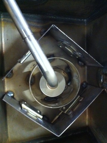

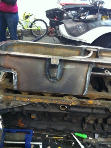

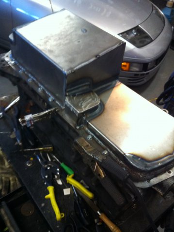

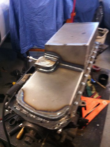

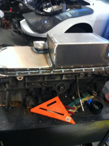

  16. here's some pictures of Wedge's pan external dipstick round baffle and trap door baffles.

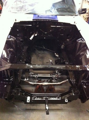

  18. The motor mounts are the hydraulic ones. I'll just have to make some shims. I have a ton of parts ordered but this weather in Georgia has shut down USPS and ups down. This sucks!!!! I have tons of work to do. I going to try to paint the engine bay this weekend.

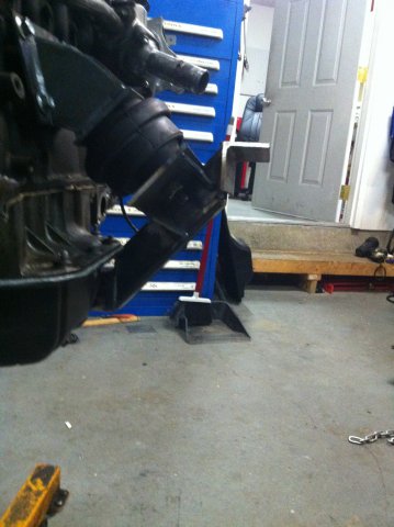

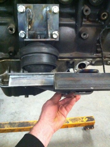

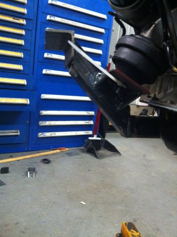

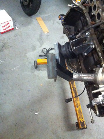

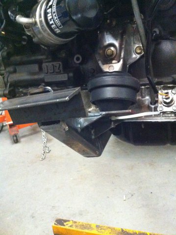

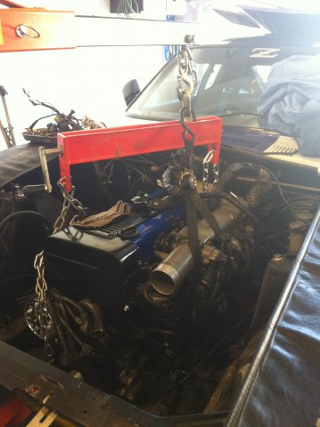

  20. Here are some pics of the mounts. I still have some welding to do.I made the right mount from sctatch and tig welded everything up. I have the stock supra mount but I couldn't get it to work with the ford f150 mounts that I used. The motor sits 1/2 of a inch off the rack and 1/2 of a inch from the fire wall. I using the r154 from a supra so I'm going to extend the shifter housing a bit Like the one that driftmotion sells. I figure I can make one for about nothing but time( I have tons of scrap aluminum around my shop) I have alot of parts on order and I'm waiting for them to show up. I had a rb20 in this datsun until a few weeks ago. I learned alot from that swap. I spent a few weeks on installing the rb and a year modifing it. I spent more time working on it than driving it. With this swap I'm going to do it right from the start. I'm going to install all the goodies (go fast stuff). I'm going single with a holset HX35 and toss the stock twins. Add some 440 or bigger injectors.

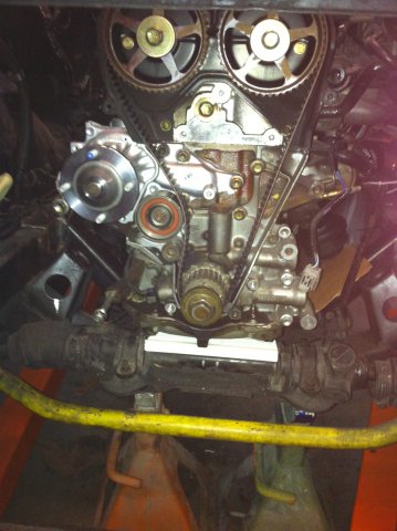

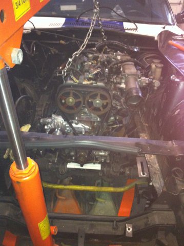

  21. Hi guys I'm starting my 1jzgte swap on my 280z. I have made the cross member and installed the motor. now I'm going to make my motormounts and attach them to my crossmember today. Here is a couple pics
  22. Trying to keep the cost down to make these pans affordable for everybody. I though I was doing a good job at that. The CAD work is $$$$$$$. And Don't forget about the cost for getting this cut with a waterjet. Believe me I have looked into it. Thanks for the improvement tip.
