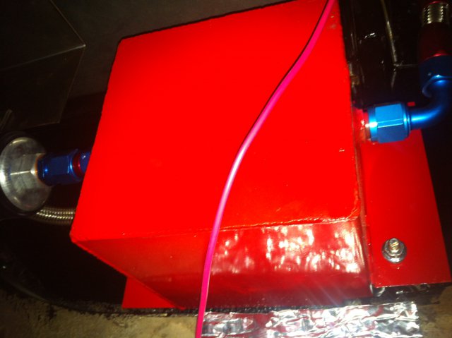

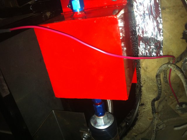

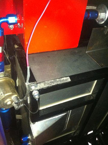

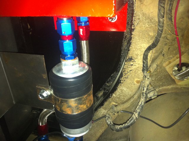

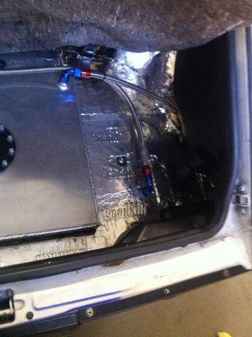

I don't mind the questions so ask away. I did the crossmember to make it stronger. The stock frame rails are very thin gauge steel and the motor is very heavy. I think the crossmember makes it a lot stronger. There is a good bit of room between the motor and the bonnet (5-6 inches) I made the engine sit about 8mm to 10mm off the crossmember and the steering rack. I used a top mpunt exhaust manifold off ebay. Thats right ebay I did clean it up a bit and add gussets and support brackets. I did all the normal stuff when the motor was out. All the seals,water pump,tensioner and t-belt,plugs and valve cover gaskets. I did to the top mount and turbo while the engine was out. I found a deal on some HKS cams when the motor swap was completed and running. I just swapped cam with the engine was in the car. The fuel cell is a 15 gallon RCI fuel. I built a surge tank and installed it next to the fuel cell. I used a carter 12v low pressure fuel pump to fill the surge tank and a Bosch 044 right after the surge tank. here here's some pics

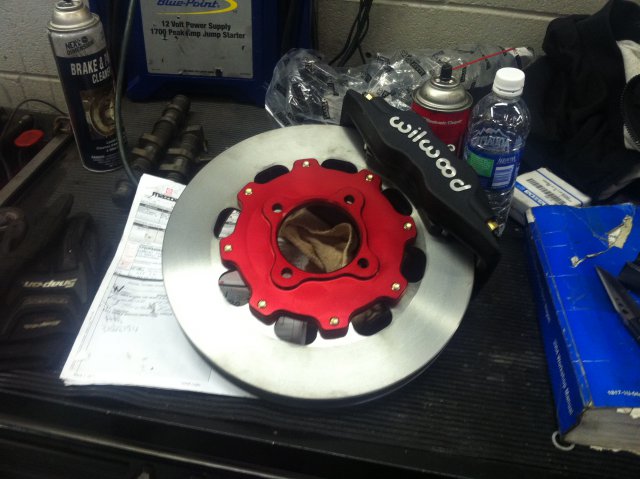

Cheaper isn't in anyway better. I've had the Toyota ft brakes and a couple months ago I decided to bite the bullet and get off my cheap butt and spend some money on a real set of brakes. I bought the AZC wilwoods and they are awesome. I was just going to go from the non vented ft Toyota calipers to the vented calipers and I said screw it. The stopping power is day and night from the Toyota stuff. I know,I know mabe with a different set of pads they would of been better but I got sick of dealing with the BS. It is the best 1700.00 I have spent on my 280z in 18 years. If you have the money do it you won't regret it.

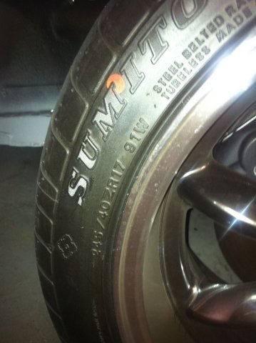

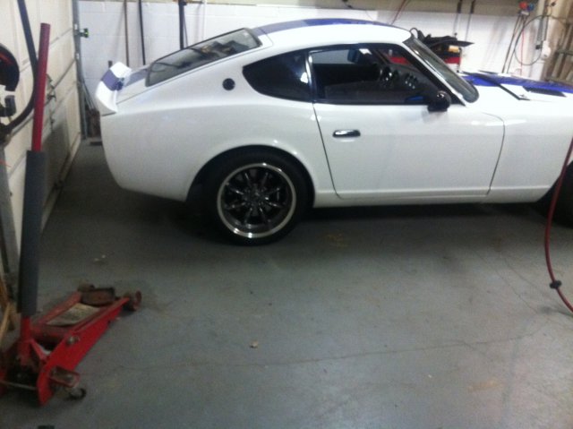

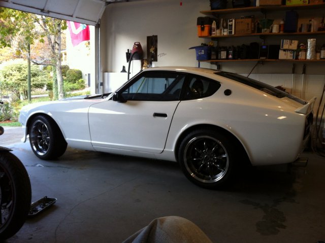

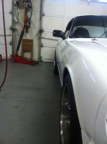

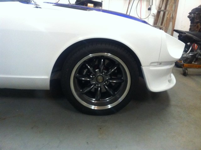

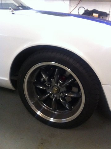

Rota RB-R 17x8.5 +4 offset. What size tires?
pat1 replied to 1siCk240Z's topic in Brakes, Wheels, Suspension and Chassis
a 205 on a 8.5 wheel would be stretched out bad. It would look like a pizza cutter lol -
No flares. I just rolled the fenders alittle. Looks beautiful. I'll post some pics in a few -
I have the same size on mine. I'm running 245/40/17 -
