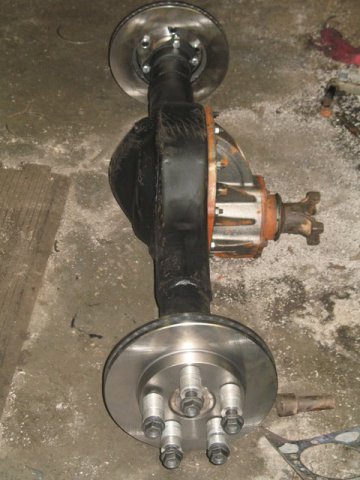

I have a 75 280 put 9 inch with S-10 disc in rear, will have either Toyota or stock disc up front. I need a master cylinder and want to locate a proportional valve to even up the braking. Wondered what most do with 9" for brakes, car will be mainly drag car and expect to get good power from my twins so want good brakes. Thanks for any help Jack

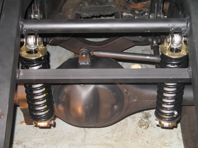

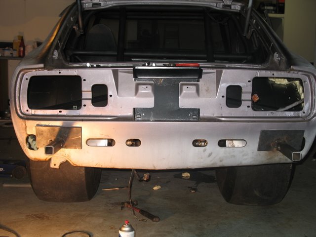

Want to run 26/10/15 slicks
jack46 replied to jack46's topic in Brakes, Wheels, Suspension and Chassis
Thanks for info. The plan is presently to go back to track and see how it does in 60's. Then determine if I need a change to larger tire--I suspect I will or hoping anyway Thanks again -
I plan on rolling the lip, also I have a cable that keeps the car from squatting so I might be ok. I have an LT1 with 224/232 and expect/hope to run <1.6 sec 60 foots. I SHOULD have ~340 RWHP. I have run it before, but my torque converter was way tight. I have one being built for it now, I live in south so we run 1/8 here so never went 1/4, that's why I gave 60's since that is apples to apples. Thanks for reply. I was hoping they 'fit' but don't want to go through alot of gyrations to make em fit.
