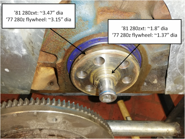

Hey all, I'm missing something. I pulled a 280zxt out of an 81 auto and want to install it in a 77 manual. The problem is, the flywheel does seem to be right for the newer engine. What am I missing? The hole that goes through the flywheel is larger than what's on the crank, and the shoulder (the backside of the flywheel should sit on) is larger than the flywheel. This prevents the flywheel to be bolted flushed to the face of the crank. It seems the '77 flywheel can't be used with the 81 turbo engine. Any advise? Or are my suspicions correct? Thanks in advance.

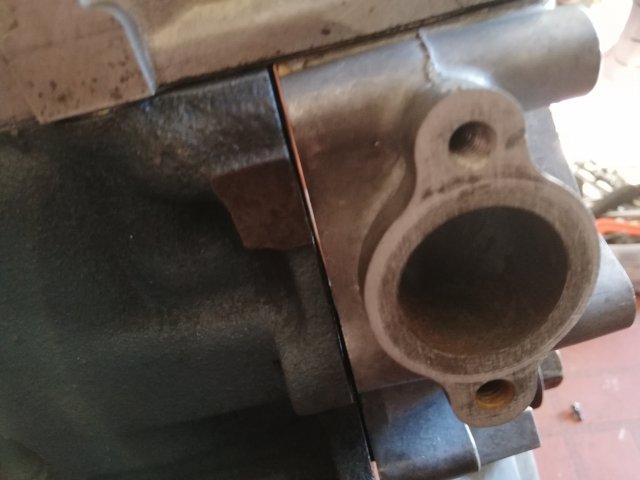

thanks for all the inputs. i didn't have it decked. but the new hg may be slightly thicker (uncompressed). after tapping a little more, i noticed that the top corner of the cover was digging into the hg. i ended putting some rtv on the corner and along the gasket, and tightening it down. -

Thanks for the response. Yes, heads torqued. Doesn't seem to make sense to me though. Did you have any troubles later down the road? Blown hg, poor pressure, etc.. -
Hey guys, I'm putting my l28et back together. The timing cover wont go back in easily. What gives? Do I need to shave the top of the cover? Here is the cover dry fitted. I've tapped the cover with a mallet, but it won't seat fully. Still a sizable gap. The locating pins are aligned to holes. Chain guides aren't in and no gaskets.
