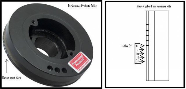

Gentlemen, I didn't take the time to line up my engine TDC and record what the notches on said pulley represents (http://www.thezstore.com/page/TZS/PROD/10-2139). If you have the timing light on the pulley, as the timing increases, the marks go down with respect to the indicator bolted to the timing cover (this is on an L28ET where the indicator is on the passenger side. See image below. My question is this: If you're watching the ticks on the pulley with respect to the 0 tick mark on the indicator, when the bottom-most tick is lined up with the 0 tick of the indicator on the engine, is this 0° advance? Thanks guys!
