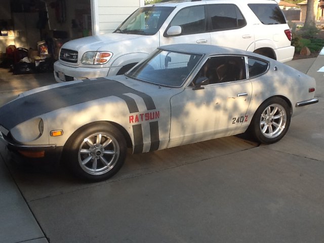

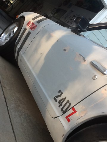

Playing with some ideas for paint schemes and came up with this "RATSUN" BRE style racing. I'm building the car for go first and show later so I'm going to have fun with the Rat-rod look while I build. I picked up this bone stock roller 4 months ago and just took first in class at my local AutoX this past Sunday. Gotta love the Z's.

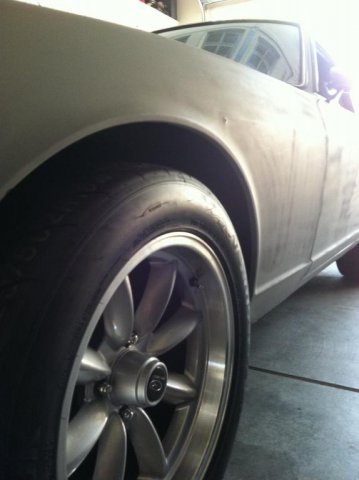

I have the large caps and they look good. I have some pics in the ebach ride height thread.... -

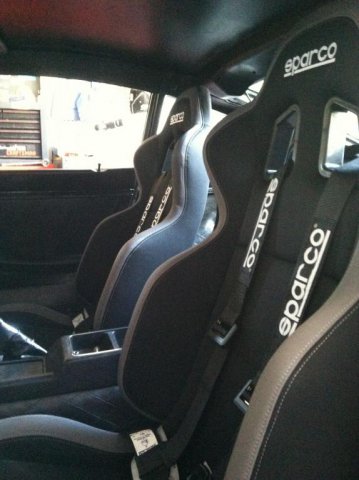

I left the stock seat mounts in... I have to try for a very slight rub with a helmet on, but plenty of clearance without. I've tried A6's (terrible fit) and TRS (fair fit) in past Z's but these are the best combo of fit for driver and fit in the car I have ever had. If you are a 6 footer or less they are a dream, at 6'-1" I'm really stoked!
Perfect fit. I'm 6-1 at 195 and I have plenty of room. I used the stock sliders with 2 new holes drilled and new holes in the stock mounting points. Easy peasy......

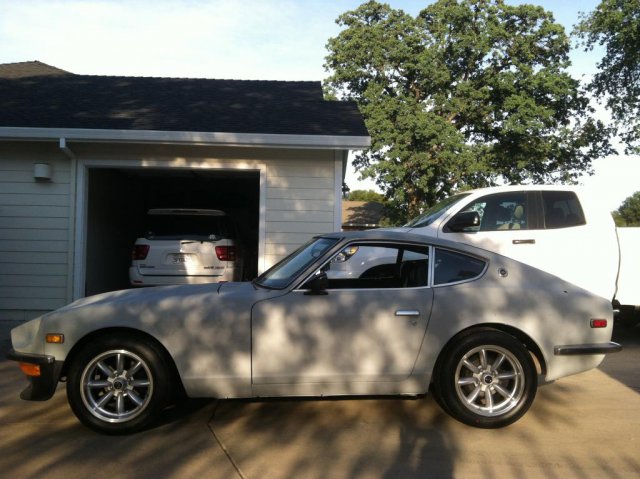

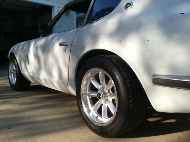

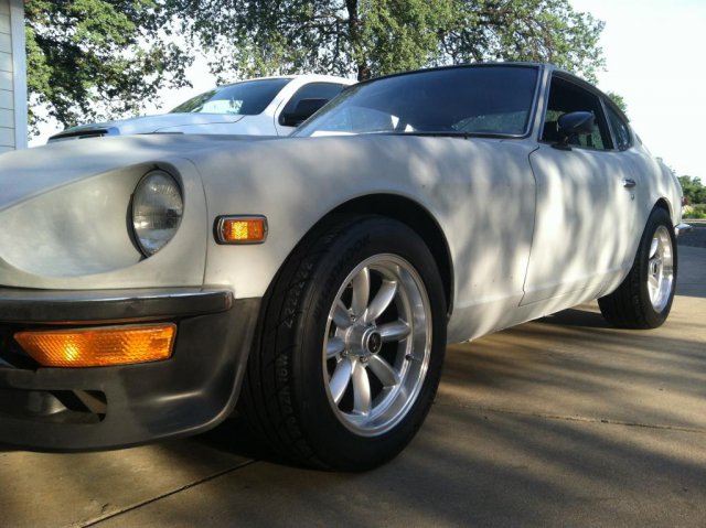

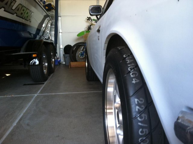

Well car is back together with a stock ride height front and rear using AZC fronts and moogs with 2 cut coils. With +4 16X8 rotas and 225 50 16 RS3's I have good suspension clearance and no fender rub. Pics coming soon, phone is busted and can't find my camera. -

Well springs and struts are in. AZC front springs and moogs with 2 full cut coils was right on the money! I have an even ride height front and rear with stock ride height to maybe a 1/4 inch drop. This is what I was shooting for. A quick sprint around the block produced no rub with 225 50 16 on 16x8 +4 rotas. ST Sway bars are up next in addition to the MSA header and exhaust sitting on the bench. I will autoX the car soon for an update and write up....... Just wanted to report the option of springs and cut lengths for a 240 for the time being. -
