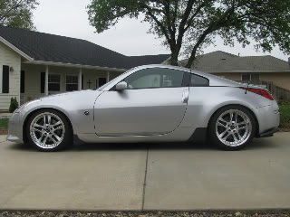

Found my Sparco seat pics.... and another past project car (03 350Z, full race suspension with remote mount turbo at 12lbs) I scattered the 350 motor at Thunderhill and lost the mojo for that car, which lead to the FFR, which gave way to soft finances and $2200 Z.... In the end, I will have less into the 240 (cough cough, yea right), and I hope it will out perform them both. I must say it will be a tall order to make the Z as cool as the FFR. Dang I miss that car! -

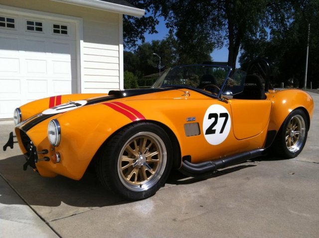

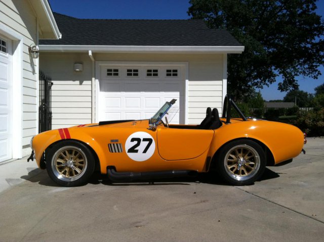

I hear you Richard but memories like these (father-daughter project Z) will last a life time... Just for grins and giggles, I pulled up my old FFR cobra to remind me of why I do this and keep my eye on prize... Hope to be cleaning up the engine bay on the Z this week. -

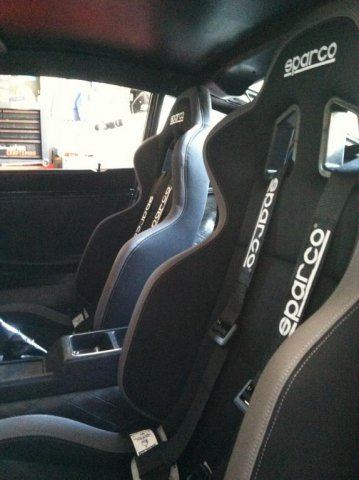

As budget allows in no particular order... Coil overs, 17 rota stagger with 245s front and 275 rears, bad dog frame supports, flares, victory spoiler, front and rear LCAs, stock gauges for now, weld in sump to stock tank with external pump and vette reg/filter strut tower supports (I like the new stuff from ttt) champion 3 or 4 row radiator, wiring specialties plug and play, brake upgrade, for starters ........ The list just never quits. My goal is a clean swap with what I've got.. The LS is cammed but I don't know specs , with a really solid runner as she sits with 225 50 16 on 16x8 rotas and current suspension. I've got sparco seats in already with harness and I've been repairing the door panels. One she is on the road and sorted I will add go fast and handling parts as budget allows. Body and paint last, they must go before they show in my garage. Thanks for the encouragement. Jim -
