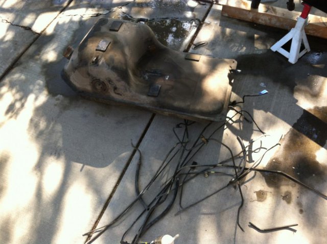

  15. That would be great.... I'm always willing to change course if a better plan pops up. Funny you should post this. The cost of hot tanking and welding in a sump is just shy of putting in a real fuel cell. I still have some trepidation about weakening the chassis though... thoughts anyone?

  17. Thanks Keith. My original plan was fuel cell but i don't like the filler option inside the driver/pass space. No need for a chute as I can't run the 1/4 to save my life lol. Strictly a road racer/autoX/mountain/spirited weekend guy. Since the Z is unibody, I worry a touch about removing the wheel well and properly supporting again with big costs..... Figure if I sump the stock tank I can always change my mind later. Thanks again. Jim

  19. Well I dropped the tank and all of the old fuel lines running down the tunnel...what a PITA. planning on a weld in sump to the bottom of the tank. Need to hot tank it and get her ready to weld.
