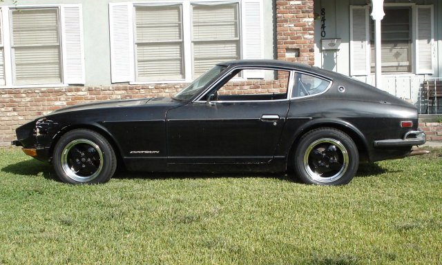

The Falken ZE912 is good. We had some and liked them. Here is a pic with 225/50-15 Falkens on VTO 15x7 +0 wheels. -
