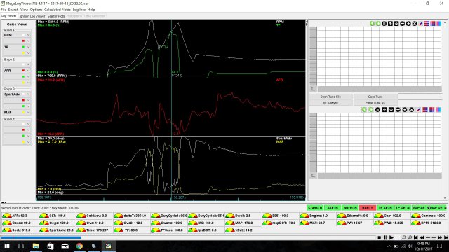

  10. Looks like I need to pull the ecu and put a jumper wire to get it into boot loader mode. I'll probably do that next weekend. Bryan
  11. Thanks! I will get that done today and report back with new logs. To answer previous questions - Nothing edited and I'm using paid versions of log viewer and tuner studio. Bryan

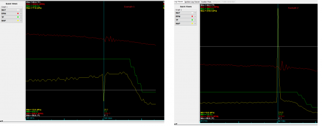

  12. Here are 2 examples. It looks like MAP is getting funky readings. One spike high and one spike low. Examples are right at the end of the logs. Thanks, Bryan Disregard 2nd image. Can't seem to figure out how to get rid of it. 2018-04-21_18.59.46.msl 2018-04-21_19.01.49.msl
  13. haven't gotten a chance to data log yet. Assume I should log FI pulse width and Spark advance? Bryan
  14. I am running Megasquirt 2 wired in similar to below wiring diagram with an 83 distributor and using the MAP sensor. Under very light/cruising conditions the power will suddenly drop out then come right back. Makes for a sudden jerk as driving. Took it to a track day last year and didn't have any problems at continuous WOT. As I type this I thought a deadspot in the TPS (although it was new 2 years ago when I installed MS) I'll check that tomorrow morning. Any other ideas that I could look for or check? Thanks, bryan
