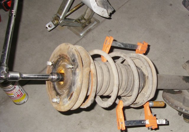

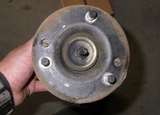

This is my first project rundown so send in the questions, I'll answer all that I can. Also the guys AJUSA were awesome for the parts. Got the best price and the kit arrived within their specified time. Thanks again Ken. Oh yeah, here is the finished ride height.
Tokico kit install I: Equipment needed A: 14mm box end wrench ratchet with extension and deep well 14mm socket. B: Tire removal equipment. (I love Pneumatics.) C: 17mm socket/ ratchet w/ ext. D: Dust boots for front struts. (These didn’t come with the kit from TokicoL.)$28.00 @ Schucks’ E: Break-free lubricant. (I don’t recommend WD40; there are many better solvents and cleaners out there.) F: Clamps or fancy spring compressor devices. G: Screw of various sizes, Flat head. (I used a small flathead mostly.) II: Pre-work A: I recommend locating the bolts that will need to be removed and soak all of the thoroughly before even attempting to remove the old hardware; maybe even the night before you plan on doing the swap. B: I did the rear setup first because it is much simpler than replacing strut cartridges. Use wheel chocks and jack stands throughout this process as the car will be off the ground for a prolonged amount of time. (I know…safety is boring, but let’s keep that way, heh.) III: Removal A: first off you will see the simplicity of this project when you remove the old shocks/springs. The Tokico kit has complete rear units; all of the old gear except the upper spring mount will be replaced. I checked my upper spring mount bushings and they were surprisingly in good shape so I re-used them. You can get new ones if you car is in need of them. B: I held onto everything to until I got the new stuff mounted the trashed the left-over’s. C: On the front struts it appeared more complex but it still what I would call Intermediate mechanic work at best, probably more like Novice. Here are some shots of the method I used to remove and replace the front cartridges. D: Remove the tension rods, the sway bar as well as the brake caliper before removing the strut tower bolts, my car has the knuckle keeping everything connected to the LCA. This wasn’t a problem I took it all apart while it was attached to the car. E: There is one tricky part to all of this. The cartridge retainer cap or the Gland nut Remember that when you are pulling the old gear you will have some compression on those old springs, if not done properly you can damage fender wells and body panels. IV: Installation A: The Rear setup is straightforward. Assemble the shock/spring with the bushing cap and bolt from the top to bottom. I say this because if you get the three bolts fastened up top (rear strut tower) then you can leave them loose and align the bottom of the shock to attach it to the LCA. Then tighten everything. Use factory torque specs for all bolts. I can look them up for anyone who doesn’t have a manual or can’t find them.
