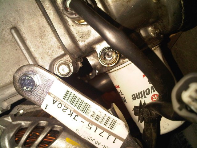

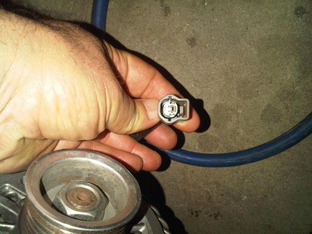

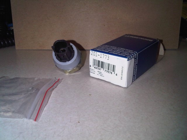

Got a new part worth mentioning for the HR. My engine was missing the oip pressure switch. This is a switch next to the oil filter (see picts) that sends info to the AC amp and thus the gauges. Well Nissan has listed the switch for the DE. This is wrong for the HR. it's a different switch, with just one pin in the plug rather that the 3 the DE has. So you'll need to buy the switch they list for the VQ37, it's the same switch as the HR. It's got a black plug rather than a brown one, and plugs into a plug just like the blue oil temp sensor plug. Anyway here's picts. This is the oil switch plug. The dirty hole is where the switch screws in. The switch and Beck/arnley part # 201-1773
