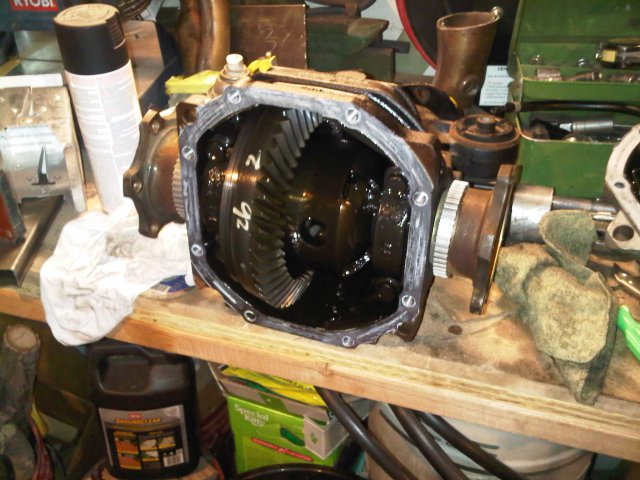

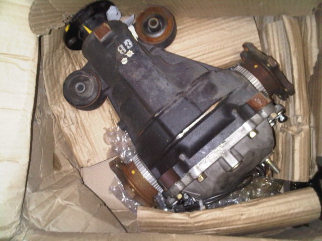

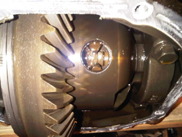

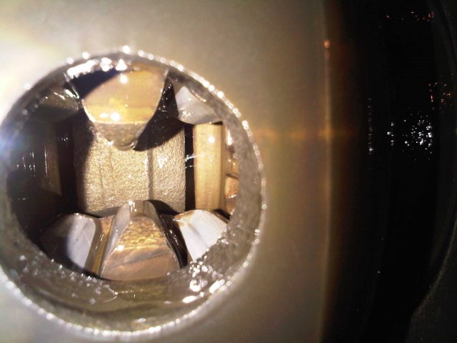

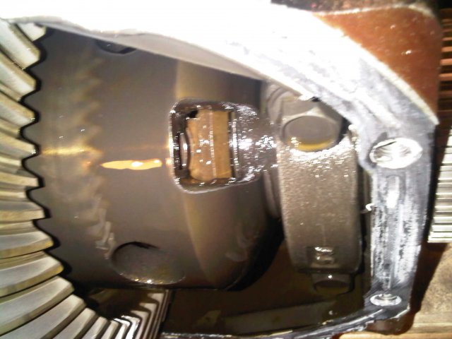

TIme for another update... I haven't got a lot done since I pulled the engine again.. I've welded on steel to wrap the frame rails in the engine compartment. (picts later) I did get a new toy for it though... A 350Z R200 short nose. 3.53 gears. I opened it up to check for damage. It acts like a limited slip but I'm not real familiar with the guts. when I turn one side, both sides turn. I looked for identifying marks per the manual but couldn't tell. Closer look at the carrier Assy in the center. Huge Spdergears. Mainly I got this because it was cheap, and that it has the sensors and rings for the Speedo.
