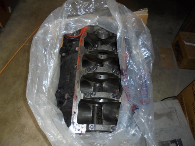

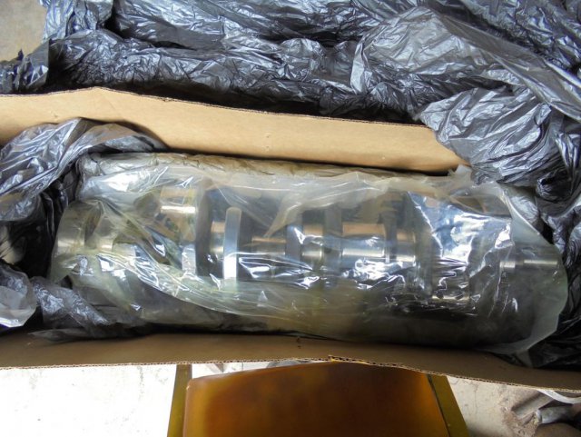

Started getting more SBC stuff in. Another block ready to clean and put together(+.030 4bm 350) along with a new Crower crankshaft. The Crower is gorgeous, just too much stroke(3.75")
