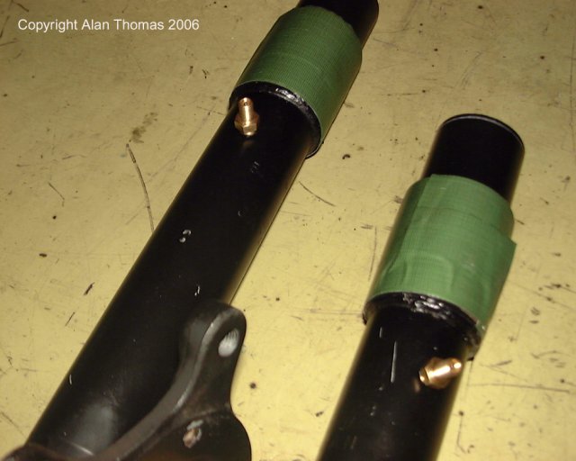

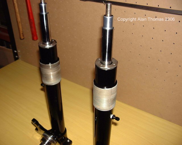

Well, three years on and they are still working fine. The guy that did it does a lot of them. He does not put the valve anywhere too low down because they can be a little vulnerable - especially on rally cars. Actually, the piston / seal does not move past that valve. It stops before that point on the tube. Hard to explain without a schematic to hand. I'll see if I can find one. But I suspect marvo might actually have a standard factory oil-filled strut that has never had a cartridge rero-fitted into it. Just a hunch.............

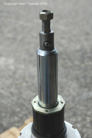

marvo, Have a look at the top of the rods ( near the screw thread ) where you will possibly see a dome-headed screw. That's where they were gas-filled at the factory. I didn't think to point this out before, but are you sure you have the proper 'Sports Option' gas-filled struts as opposed to the factory standard units ( which we joke were filled with fish oil....... )? The part numbers engraved / stamped on the tubes should tell you for sure. There were lots of different versions - some 'Rally' versions even without the adjustable lower spring platform, but with longer tubes - so you might struggle wihout all the part numbers. They might not have survived, but most of the gas-filled Opt. units had warning stickers in English and Japanese ( early versions were square shape and a goldish-tinged colour, with later ones oblong shape and chrome silver with blue writing and border ) telling you that they were gas-filled, and not to push the rod in or out with the strut inverted. What have you got?

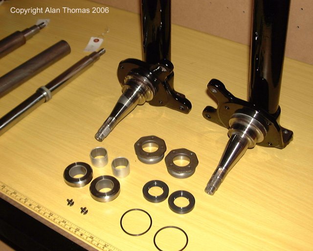

Some clues as to what you will find inside, and an example of the weld-on Schrader valve method of re-gassing:
Opening one of these up is a one-way street........ The factory had a neat setup fixture for assembling them, but if you take them apart then you will have to weld to the tube a fitting to house a Schraeder valve. You will then need to know what pressure to put into it.......
