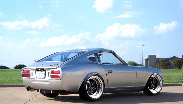

OMG - $60/ft? I bought 10 ft of 3" and 5 ft of 2.5" ALL for $50. And that was from a muffler shop. I guess if my girlfriends cooch expelled $100 I could afford tubing like that. But oval tubing is a good idea. And this is more of what I was thinking (see attached) - something that pops out of the body/side of car. I can see what you guys mean by heat being an issue, but how much more hot can it get just by coming out the side. Your essentially reducing the amount of tubing.
agreed, i love the stock taillights. I only wish mine were LED's
I would throw on some headlight covers. Are those the fiberglass bumpers? or just painted black? I really like the exhaust, sexy as hell. good looking car, but that is a ton of work. If I was gonna spend money on the body like this guy did I would weld in a wide body kit. Nothing, in my opinion, makes these Z's look hotter.
personally I like the flush background, but it is a very cool idea nonetheless. If done right and you make sure it blend that panel in perfectly then I say go for it. You never know, you may start a trend. I know I haven't seen it before - but then again I am a young'n and haven't seen anything compared to some of the dinosaurs on here.
So the motor (SR20DET) is installed - thanks for Mckinney for the Motor mounts - and now it is time to build an exhaust. I decided on running a 3" straight pipe and am planning on having it come out before the rear wheel (left side). I am not sure if anyone has done this before, but can anyone here see any issues I may run into when building the exhaust? Also, can anyone think of any con's reguarding running a side exhaust (apart from the noise and black soot on side of car.) Im doing this for a couple reasons: 1. Side exhausts are mean looking 2. I want to run a 3" straight pipe 3. I dont care to run it under or over the rear suspension 4. I like to play with my welder Thanks all, I will photo document the event and be sure to post them up for your viewing pleasure.
