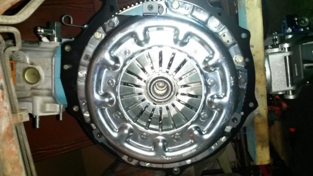

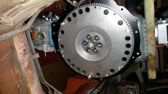

Everything posted by Dat73z

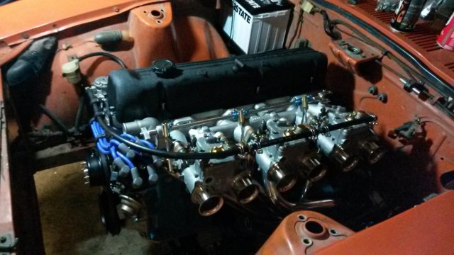

  1. So I need to pull my header to remove my transmission. I have not run the engine with this gasket and I liberally slathered the gasket with anti-seize. Anyone think I have a shot as re-using the gasket or should I just bite the bullet and order another?
  2. Did not even need to slide prop shaft in, transmission output shaft rotates freely in neutral between my fingers. Removed starter, flywheel visible still no dice, engine stuck. So I suppose this leaves me with pull the transmission and inspect?

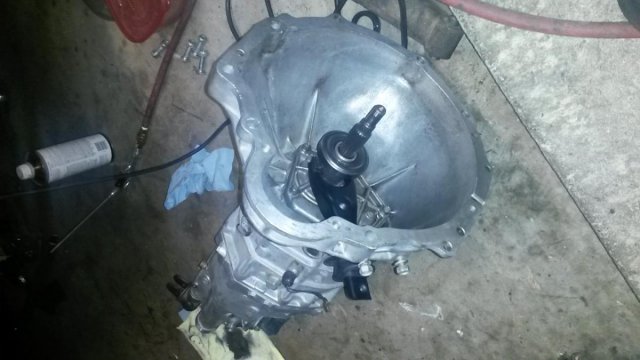

  3. So was not the clutch slave bolts. Also filled and bled the clutch system, and set up my phone to record. Clutch fork movement is superb, no binding and functioning as intended. Pedal feels great, a little more effort than the factory 240z, but everything in the car was leaking before. Engine still won't turn. Going to slide in the prop shaft and attempt to rotate trans in neutral then onto starter. Will report back with results. Thanks for the help guys.
  4. Thanks NewZed, I'm going to give that a shot later today to see if I can narrow this down. I'm pretty sure I used the OEM 240z or 280zx slave cylinder bolts based on the picture above, but I recall recently reading about that potential issue as well.

  8. Hi, Does anyone know the correct orientation for the intake / exhaust gasket with metal backing? I searched online and found some pictures which show this gasket installed with the metal backing either way. In speaking to some Z people it sounded like the metal backing needed to go towards the header so that is how I've currently installed it. My repair manual does not detail this and the MSA exhaust gasket looks a lot different than the one I'm using (Harada / Kameari). I've attached a picture detailing how I've put the gasket on for now. Check out the area by the header for the metal backing. Can anyone confirm if this is correct / incorrect? Thanks!

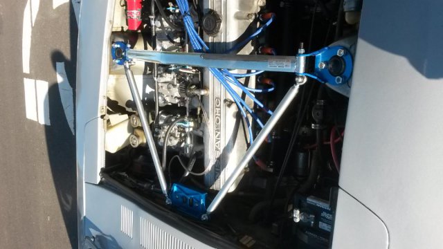

  12. Agreed- for a dedicated track tool there are better options out there which would be better suited for increased torsional rigidity (ex: that awesome z above). For a truly bolt on option and bling factor though, it's hard to complain!
  13. Can confirm T3 triangulation bar fit with Cusco bar- here is a picture I took yesterday of a fellow Z enthusiasts' engine bay. Looks great!
