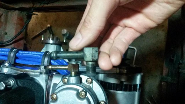

Thank you takayuki, it was indeed 1/8 BSPT.
Thanks Tony, attempted measuring against NPT tables earlier in the week with no result so that makes sense. Any idea of the JIS/Metric size? Otherwise will attempt once I wrap up the work week here and report back with a size.
Does anyone have any idea what size threads the tapered fittings on the factory mechanical fuel pump are? Is this a common fitting that can be purchased off the shelf? I've attached a picture of the fitting in question. Thanks!

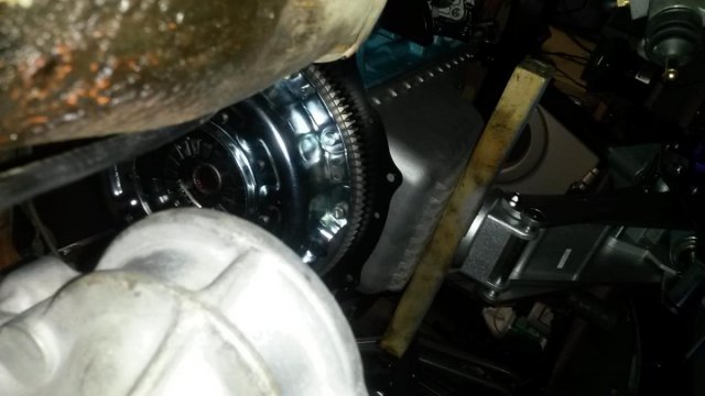

Alright so I pulled the transmission earlier and everything looks great. Motor is still absolutely stuck. Torque wrench set at 100 ft-lb on the crank snout will not turn it. Going to throw on the new OEM trans mount and powdercoated bracket then start tearing back into the motor.

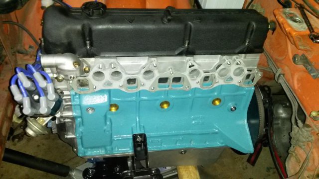

So just inspected the timing cover again and it's definitely not jammed. Also I do recall turning the motor over by hand after the crank pulley torque/install. Attached a pic from inspection just now. Going to start pulling the transmission. Not an ideal scenario, but usually it's spend an hour in the garage listening to music while drinking beer and 20-30 mins to actually pull a trans. Will report back soon.

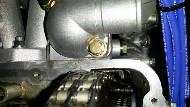

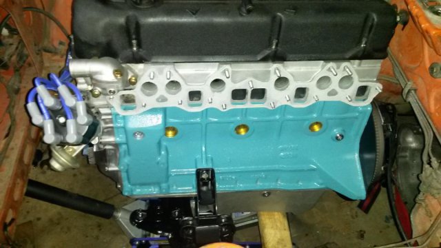

Just dropped the oil pump to check the timing chain tensioner, hard to make out in the photo but it looks tight on the alternator side of the motor to me. Slack side of the chain has some slack as well. Not sure about keeping the chain tight, was just careful to not bump anything out of place with the front timing cover off. Here is how I went about replacing the seals at the front of the motor: 1) Drop oil pan 2) Impact gun + thread on pulley puller to remove crank pulley bolt + washer 3) Remove front timing cover 4) Replace crank snout seal 5) Bolt front timing cover back in place with new gaskets 6) Bolt in AZC oil pan with new gasket 7) Lock flywheel and torque crank pulley bolt + washer back to ~100 ft-lb with loctite blue Also checked if the motor would turn CCW. Set torque wrench to 50ish ft-lb and attempted but no dice. Yeah, I drained all of the fluids from the motor due to realizing my water pump was vomiting out of the weep hole something furious. No overheating, caught it right at failure. In the process I realized that the block freeze plugs were starting to go along with everything else. This was maybe a couple of months ago (I'm a slacker), but now on the tail end of the refresh process so probably not completely bone dry but not lubricated as in I ran the car yesterday.

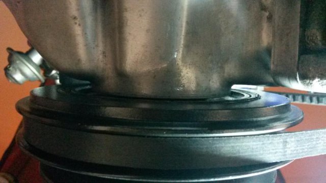

Thanks, just took a quick peek at the Tstat housing and bolt looks to be the correct length. Picture attached. Only running alternator belt, but it's on there finger tight (e.g. no tension) at the moment.
