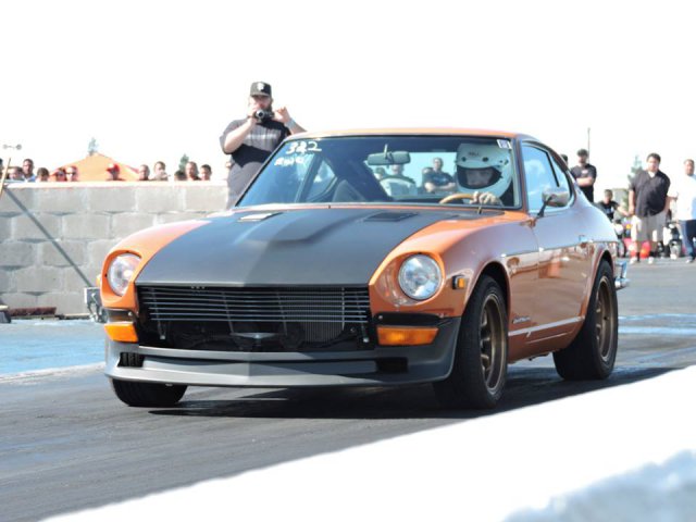

My set up is kind of wonky, I started a turbo build and then went to nitrous. The motor is an iron block 5.3 with 243 heads with aftermarket springs and push rods. A ls6 intake and the cam is a small custom grind reverse split. On motor it puts down 300whp through the TH400, which is pretty good considering its a low compression set up.
