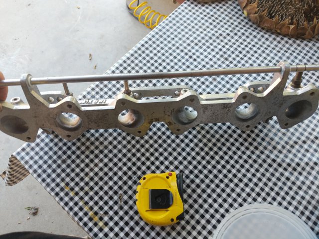

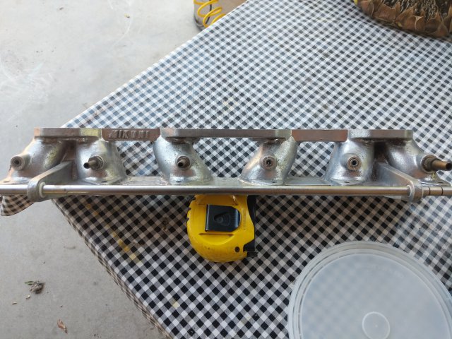

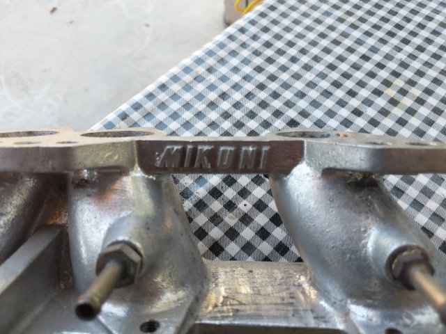

Hey all I just picked up this Mikuni manifold and was wondering what these normally sell for. I have searched around and I couldn't find much info on these manifolds, just that for a short time Mikuni produced these along with their 44's as a package deal. Thanks for any info
