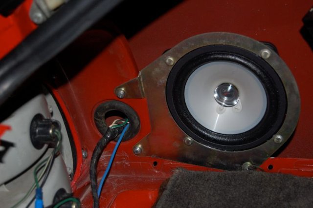

I am looking to add speakers to my 1976 280z. Just looking for decent sound, nothing special. Not looking to put speakers in the doors or kick panels. Also putting an enclosure in the hatch area also out as I don't like that option either for the aesthetics and loss of hatch space. I have found the following options: 1) Factory location: 5 1/4 speakers that mount in the rear quarter panel area Pros: no modifications needed. Cons: I've read that the sound is terrible. Need to acquire/fabricate brackets 2) speaker adapter kit to mount on rear plastic trim that covers tail lights Pros: super easy, cheap Cons: unknown speaker size, sound quality. Mounting to the plastic trim piece probably doesn't yield good sound output. I haven't called this company yet. https://zparts.com/index.php/product-category/280z-parts/interior-280z-parts/ 3) mount speakers in storage compartments Pros: not much fabrication?? Large speakers(6x9?). Quality sound? Cons: lose storage space I think the storage compartment looks like the best option. Has anyone this and can comment? What about the other options? Thanks
