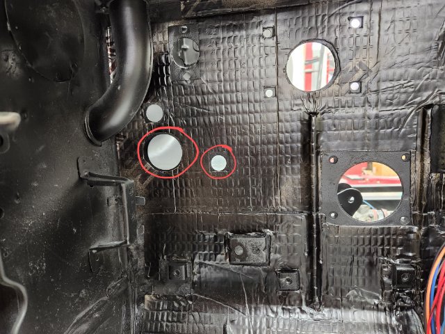

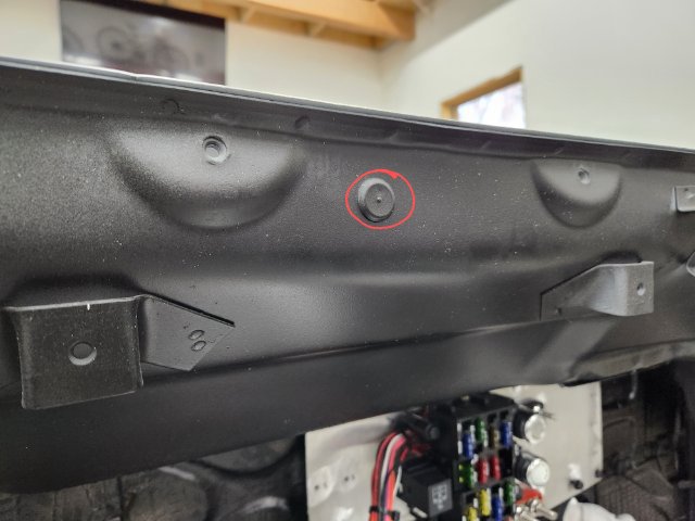

I have a 1976 280z. I am in the middle of a complete teardown and restomod. I got the car as a shell. I am wondering what these 2 holes are for in the firewall? I believe the smaller hole above those 2 circled in red is for the hood release cable. Also, what is this plugged hole that leads from the upper firewall behind the dash that goes into the inner cowl is for? Thanks!
Bump still looking
