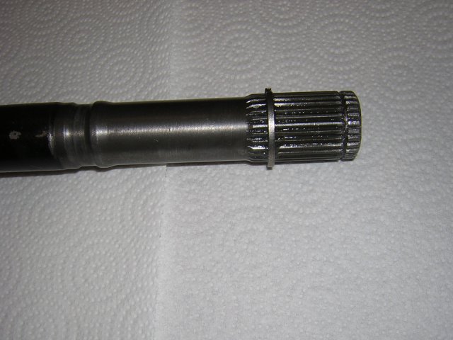

Well, I grinded off about 5mm off the end of the CV and that looks like all I will need. Dan was right, a little grinding here and there and it fits without a problem, at least on my setup. I took about 4mm off the stub axle (couple thread still showing on the nut) and 5mm off the CV (end cap removed). Just to make sure everything was going to be okay, I took the spring out and moved the suspension through its travel. You get the most binding from the CV to the axle at full droop, not compression. A little gasket sealer on the companion flange to the CV and it's a done deal. The picture with the nut in between the outer CV and the companion flange is the suspension on the end stop (full compression). You can see gap between the stub axle and the CV actualy get parallel, thus creating an even larger gap.
I thought about doing exactly that, but you have to move both ring grooves. On the other end of the ball bearing cage there is another end stop ring (about a mm thick). I may still go that route, but grinding off 4mm may be enough to do the trick. Not sure I want to go without the snap ring, it would allow the inner part of the ball bearing cage to slide into the end of the stub axle which may or may not be a problem.
Okay, I think I know what you're talking about now. I assume it changed the distance the CV sits into the pumkin. Can you post a pic? I took some measurements and I can get away with grinding the tip of the CV that goes into the companion flange. It's about 6mm from the end of the snap ring groove to the axle tip, so I could probably grind about 4mm and leave 2mm to hold the snap ring, that sure beats a custom set of axles.
Freddy, I'm not so sure that is a good idea running without the locking ring. I assume you meant the snap ring. What about the other side of the ball bearing cage with the other locking ring? I thought about taking mines to a shop to be shortened, but I do not think it is possible. The axle tapers after the spline and cannot be resplined. I'll go price some axles out just to get an idea if this is going to be painful.
The companion flanges are not what is hitting. It's the stub axle to the tip of the uncapped CV axle. I could probably grind a bit more than a mm off the end of the CV to get it to fit without hitting. I have already grinded about 2mm off the end of the stub axle, anymore than that and there is almost no thread sticking off the end of the nut. I think tonight I will take the shock off, reinstall the CV and check to see the clearance through its travel. If it looks too close I think I will take apart the CV and see what it's going to take to shorten it or if it gets to expensive I'll go for the aftermarket control arms.

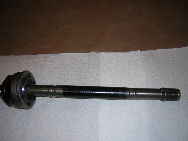

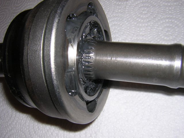

I have another CV for the driver side and it is identical in length. I ran back outside to check it and there is only one part of the CV that slides in and out, the ball bearing cage. The other part just rotates like a ball joint. Both sides had the pictures taken with the both shafts "clicked" into place.

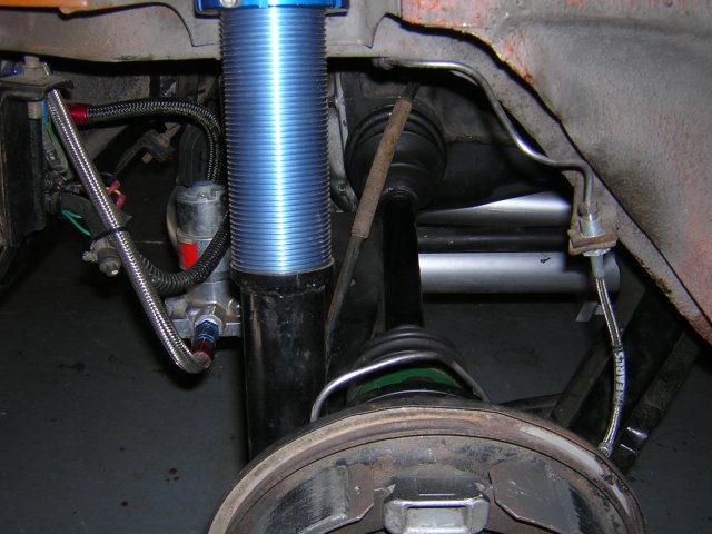

I put more pics just to illustrate the point. See how close the inner axle of the CV is to the stub axle. The outer green bearing cage is the part that does most of the moving in and out. In normal driving the car never has the control arms drooping that far down so the CV would square up against the stub axle when the car is resting on the ground. This is also without the end caps! I think I'm going to send these axles out or at least price having them shortend up about half an inch. If that gets to out of control expensive, I'm going to opt for the aftermarket control arms.
Just for reference I put some pictures to show the angle of my halfshafts. They are just about perpendicular to the diff. There were some ideas for fixes, custom axles, move the slightly forward I just havent had time to realy try anything yet.
