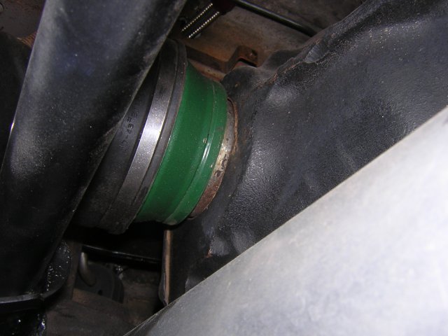

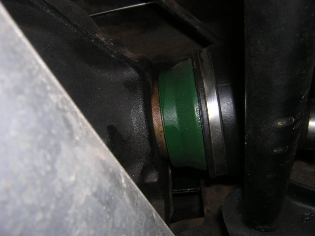

okay, I took a couple of pictures for reference. Keep in mind, this is the 300zxt shafts on a power brute lsd. The gap is approximately 3/8 of an inch.

I think part of the problem does lie with after market LSD's. I run a power brute LSD. I'll try and get a picture tonight of the distance between the driver side CV and pumkin. I'm guessing it sticks out about 3/8 of an inch.
