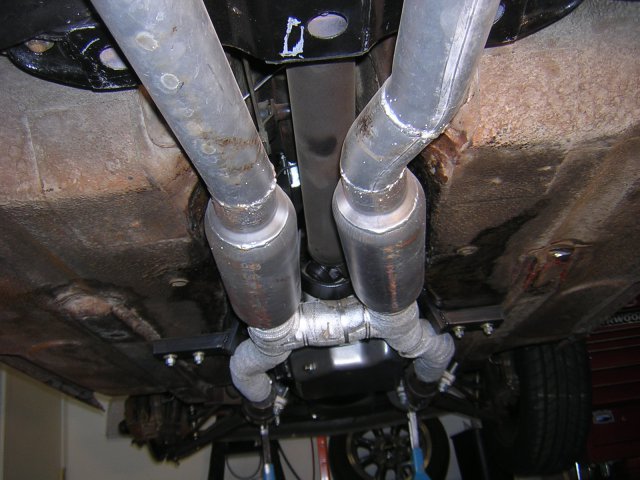

Keep in mind some aluminum driveshafts are bigger in diameter. In the 240z, there is not a lot of room in the tunnel if you want to squeeze in a dual exhaust.

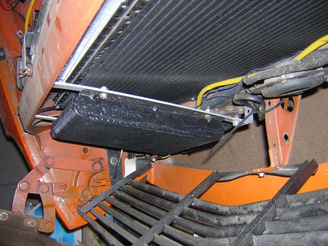

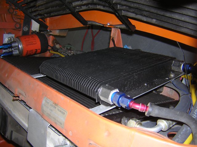

I can't say succesful since it my car has never been out on a road course, but I attached a picture of what I did. My cooler is really for a transmission, but it could easily have been an engine oil cooler as well. I also relocated the filter up front as well. Note there is a condensor for ac in between the cooler and the radiator. The 280zx turbos had the cooler mounted in the passenger wheel well, but if you are going to do that I would put a screen over it to keep rocks from dinging it up unless you run a stacked plate style cooler like the B+M ones.
