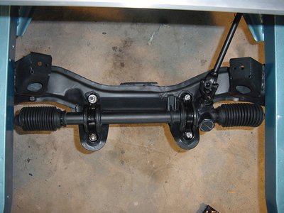

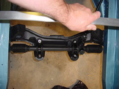

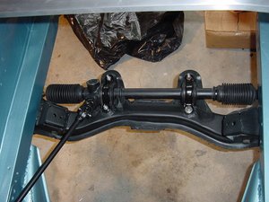

Hi: No not 100% but the rack dosen't sit square to the crossmember.I'm in orange county NY. Mike
HI: It dosen't appear that any one looks at the old posts,I was hoping that somone would have a spare crossmember that they would like to sell.Sorry to post a new thread.
Hi: Anyone have a spare crossmember that they want to sell.Somthing wrong here, the rack dosen't sit right.Seems like the crossmember is twisted out of wack. Any Ideas!!! what do you guy's think. Rack boot hits croosmember.somthing wacky!! Thank's mike
Hi: As you Know cygnusx1 is helping me put my car back together after redoing the engine compartment.The steering rack sits crooked on the crossmember.We don't see where it is bent or anything out of alignment.The car was hit in the front at one time before I bought it and repaired. All the damage looked to be in front of the crossmember.I hate to put it together out of wack,It will only wear and rip the rack boot again.Does anyone have a non-bent spare crossmember laying around that they might want to sell? I would like to see if it's the crossmember,Mine dosen't look bent,but maybe!.Cygnusx1 checked his and has about 1" between the boot and the crossmember and his sits straight. MY z is a 77 his is a 76. Thanks Mike
