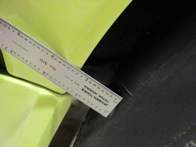

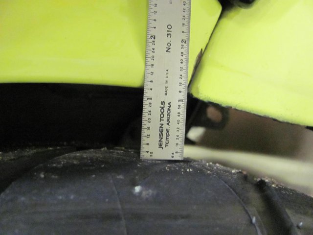

My current predicament is that I can't get more than 2.5 degrees of positive caster out of the car without rubbing my tire against the fenderwell / front bumper. Before the start of next season, I'd like to be able to dial in between 6-8 degrees of positive caster. However, if at all possible, I'd like to avoid cutting / flaring my stock fenders. Is this even possible? Here's the rundown of my current setup: 245/45/16 tires 16x8 wheels with a +26mm offset MM Z31 hubs (+3/4" further outboard than stock) Sectioned struts with GC coilovers, hypercoil springs, and tokico illumina struts Mikelly adjustable front control arms Mikelly adjustable T/C rods MSA bumpsteer spacers This is how it sits in it's current configuration: I've been looking at these: http://www.k-mac.com/pages/newprods/datsun/datsun.htm But no one can seem to tell me exactly how much caster I can expect out of them. It's almost like I need caster plates, not camber plates! The car is intended for autox, light track, and light street duty. I'm more concerned about what's right from an engineering and handling perspective than comfort. Any and all advice would be greatly appreciated... even if that advice is "just suck it up and cut cut cut if you want track alignment specs!" -

Ha! Sorry for the confusion, guys! It's definitely an issue of the wheel being too far forward, not too far up in the wheelwell. The coilovers have been set so both sides of the car are at roughly 6.5" from the rocker. Dan -- Thanks for the tip. I'll see if I can hunt anything down. I suspect that "it's just the way it is", which leads me back around to my original question of whether or not fender flaring is a necessity in the future. However, I'm going to look over the entire front suspension again with a buddy to see if I missed anything obvious, or bolted something back in the wrong way. -

Thanks for all of the replies! To add some additional info: I've got 10" 250lb hypercoil springs up front, on the ground control coilover kit with the MR2 tokico illuminas I'm also running a set of Mikelly's adjustable front control arms and adjustable tension compression rods. I also replaced everything I could think of in the process of the rebuild -- the ball joints, outer tie rod ends, the poly-urethane T/C rod kit, steering rack bushings, etc. Lastly, I added on bump steer spacers at the knuckle I can't speak for the shape of the crossmember, but the car (supposedly) has never been in a wreck (minus a tree limb falling on it and damaging the hood). I would certainly hope that the LCAs would be okay, coming from one of Mike's batches. I'll certainly check both out, though. Unfortunately I didn't perform any similar measurements to the car when the 4-lug 14's were on it, which would've gone a long way in determining if this is something new as a result of the "new" components or an install mistake, or if the car sat with the same "offset" on all of the stock gear. -
I just recently finished sectioning the fronts and attempting to squeeze 245/45/16s with 5" of backspacing (-3/4" for Z31 hubs) under the factory fenders. I noticed a strange oddity after-the-fact where the passenger side wheel appears to be nearly 1" closer to the fender than the driver's side wheel. As such, I only felt comfortable having the alignment guy push the caster out to around 2.75 degrees. Ideally I'd like to be able to go up to 6 degrees in the front (autox and track days). It looks like I can get 0.7" out of both height and width if I switch the fronts to 225s, but I'm still not convinced that's enough, as I can induce scrub right now on the passenger side even with the fender rolled and the front valence trimmed a bit. I'm pretty sure I already know the answer to my own question -- that I need to flare the fenders if I want to run any more caster. It's just frustrating knowing that 3 out of 4 wheels have absolutely no issue, and if the passenger side had the same clearance properties as the driver's side, I likely wouldn't have any problems. Although short of shimming the passenger side fender, and leaving massive body gaps around it, I'm not sure what else I can do -- other than turn to you guys for either suggestions or confirmation. Thanks any advance for any advice offered! Passenger centered, roughly 1" clearance: Driver centered, roughly 2" clearance: Passenger turned worst-case, virtually no clearance: Driver turned worst-case: Roughly 1" clearance...
