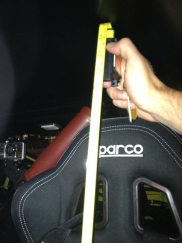

If you ever find yourself in or near Atlanta, feel free to let me know! I'll be happy to take you by the shop and let you check her out. Heck, pick the right weekend and you can go for a ride-along or two at a local event. In the meantime, it looks like you've got 35-36 inches, give or take, from the bottom-most point of the seat to the roof:

5'11, 33. My co-driver is 6'1, 32. I'd venture a guess that even he has an extra inch of headroom, and not a small variety of helmet either. I can try to take some pics of the space if it helps, or straight measure the bottom of the seat to the roof. The R100's have a dip in the seat, they actually sit lower than the stockers, even on stock rails, depending on how you choose to sit in them. Stock rails were a nice-to-have basically sheerly for passenger ride-alongs or occasionally having alternate co-drivers. We could've gotten them at least an inch, if not 2 inches lower just by welding some basic stock steel onto the factory mounts and deleting the rails entirely.
Just an FYI -- These work beautifully also with a cage (see pic). I got them mounted on stock rails for forward and backward movement, the recline works just dandy, the height is perfect for windshield visibility and helmet clearance, and it fits around my roll cage. I couldn't be happier!
