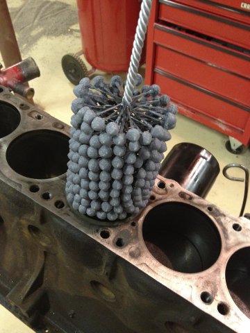

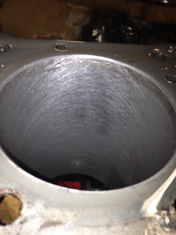

Check out this link, exceptional write-up on the majority of what you're looking to do: http://datsunzgarage.com/rebuild/ I picked up the same hone he recommends on the page, bought the exact part number referenced, and got the finest grit they made. Turned out great in my case, all done with just a simple cordless drill! You should super install new rod bolts, particularly if you intend to daily drive it for a long period of time. The factory bolts are stretch-to-yield, basically this means that when they're torqued to spec, the actual bolt stretches and conforms to lock into place. They're never meant to be re-used, as if you attempt to re-torque them to spec, they'll stretch again, weakening the strength of the fastener. I found a set on ebay for I think $60. A lot cheaper than repairing a piston through the block if you re-use them and they end up snapping. From what I've read, main bearings seem to rarely be of any issue. In general the answer is always yes, since you're already 90% of the way there in terms of the work involved, but I personally didn't bother. I checked the spec of one of the mains with plasti-gauge (the main bearing I had to pop out to replace the rear main seal -- which I do recommend doing while you're there) and it came out to spec, so I left them all alone. I did go ahead and replace the rod bearings. You've gotta take the rodcaps off anyway, and they're relatively cheap as a set -- very cheap insurance in my book. Personally, I did: New rings, new rod bearings, new rod bolts, new rear main seal, new oil pan gasket, new front cover seal, new head gasket, and new intake/exhaust manifold gasket. Ran it hard just today, still slowing dialing the timing back up -- zero smoke, plugs read perfect, 160+ compression across the board -- Very pleased!
I'm definitely not an authority of any type regarding motor rebuilds, but just from my most recent experience, it seems to me like you should be fine without a re-bore and just a new set of rings. In my case, the fact that the cross-hatching was gone is an actual indicator that of wear inside of the bore of the block, and yet I was able to re-hone and apply new rings that were in spec without any issue apparent as of yet. I'd say the fact that you see cross-hatching is a good sign. I'd also expect that rings themselves to wear as opposed to the ring lands on the pistons themselves, especially given the fact that supposedly ours all came with moly top rings from the factory. I believe the oil control ring set is cast, so if there's any wear to be found regarding the depth of the ring land, I suspect you'd find it there. Unfortunately if you posted this a week ago I could provide actual depth measurements that I experienced on my pistons, and ring-width for a new set, but mine's already buttoned back up and I hope to keep it that way for a long time to come! Also please do take note if you go through northern to ensure that you have the right set specific to your model. 280zx ring sets are different than all S30s, and they're also different between the turbo and N/A version. Additionally I found that most do stock the correct set, but it's chrome (which you don't want) as opposed to cast or moly+cast. There was someone selling a set of F54 pistons recently in the classifieds. Perhaps you could find that post and, if they haven't sold them yet, see if they'd be kind enough to measure the depth of all 3 ring-lands. Outside of that, maybe Tony D or John C will chime in here and provide more statements of fact as opposed to the theoretics that I'm spewing.

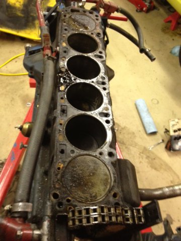

Just wanted to update this thread in case it helps someone else in the future: All pistons and rings on the pistons pulled, every compression ring spun freely and virtually every oil ring was seized. It just so happened that the oil rings in the two cylinders that were heavily consuming oil were seize "shut" and more clamped in around the piston (less gap), and the others were seized in more of an open (more gap) state, which I assume is why this condition wasn't present across the board. Two of them that were stuck the furthest open actually managed to leave some scoring across the cylinder walls where the sharper edges from the ring-gap sat on the oil rings. I using the Hastings ring set as mentioned above (Thanks again, Lazeum!). The top rings are cast as opposed to the moly that came from the factory, but at least they're not chrome, and the fitment was perfect. Measured out the gap across all cylinders, completely within spec. I used FLEX-HONE per the recommendation of this page: http://datsunzgarage.com/rebuild/ Cross-hatching turned out great, and the scoring disappeared as well! Two tools absolutely essential to this process were a ring spreader, for removing the old rings and also installing the new ones, and a ring compressor (not sure of the official name here) which basically looks like a big aluminum cuff that can be expanded to fit around the piston top and compressed on it to compress the rings and allow for easy installation back into the cylinder without risk of scoring the walls or popping a ring out. Also went ahead and put in new bearings as well as ARP rod bolts to avoid the potential for disaster with the torque-to-yield stock bolts (Thanks for the heads-up, Tony!). All in all, the rebuild went smoothly... Except for that bloody chain tensioner! I used the block of wood trick (that I've done several times now with success), but somehow across the process (probably from flipping the block upside-down and rightside-up for the ringing process so much) it managed to slip just a hair. I couldn't manage to get the cam gear lined back up... so off went the front cover! 3 hours of basically wasted time later, I had it all re-assembled with a fresh gasket (thanks, 24 hour autozone). She fired back up almost immediately, and with no issues, even with just 4 degrees of timing dialed in (being conservative to start on the high compression combo). Aside from an initial smoke-screen, the rings appear to have done the trick with what only appears to be extremely minimal smoking even though I haven't had the opportunity to attempt to seat the rings. Unfortunately, I did not put the front cover back on with sealant at the corners per the service manual (DOH!), so the front cover is now leaking. As such, I haven't had the opportunity to fully seat the rings and report a complete success, but all initial indicators are extremely positive. I'll update this thread again once the gasket issue is resolved and I have the opportunity to seat the rings, read the plugs, and run a hot compression test. Thanks again to all for the assistance here... she's so close! -

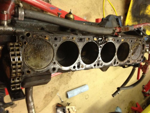

Update: Pulled the motor again and popped out both the worst and best piston. The problem was 100% stuck rings. In cylinder #2, which appeared to be the most oil soaked from reading the plug, both compression rings spun freely, but the oil ring was completely compressed and stuck shut, so much so that it took tapping against the ring gap with a flathead to free it. The #1 cylinder, which appeared to be the least oil soaked, actually also had a stuck oil ring, but it was stuck uncompressed and protruding out of the ring land, it also took almost no pressure by hand to free it. My best guess is that this is fallout from it being a junkyard motor, which probably sat out in the elements for an extended period of time. That said, anyone have any suggestions for good replacement rings? From what I understand, the 81-83 N/A 280zx (F54s) use completely different rings than the 280z and also the turbo 280zx's. Unfortunately, MSA wants $250 for the set! I can't seem to source a Perfect Circle set at all that isn't oversized, and the only other vendors I can find (eBay) aren't leaving me with much confidence that the rings that are delivered will be _specific_ to a 81-83 N/A 280zx. :-/ -

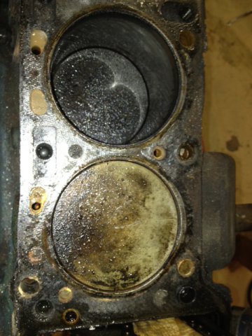

Not especially, but given the oil + coolant milkshake explosion due to the warped head and obliterated headgasket, it's a big hard to say. Here's a shot of #1 and #2 (left) right after I took the head off. Granted, this was after I also rotated the crank to TDC, so it isn't exactly as it sat in the junkyard... Thanks for the response... you're probably right, blown oil ring and OK comp ring. At the end of the day, I think the answer is that I should've re-ringed the darn thing before ever putting it back in, especially given it's unknown history. Would've cost me $30-40 and a few hours. :-/ -
Short version of a long story: Picked up a junkyard F54 / P78, which looked like this once disassembled: Upon further inspection, the head was clearly warped, but the deck seemed to spec out fine. Swapped on a known good head, brand new headgasket -- leak down numbers come out great, no more than 10% across any cylinder, and with a less than 5% variance across all 6. Same with compression, 160-165 across the board. However, immediately upon getting it back on the road it was fogging up the entire neighborhood. After a few miles and WOT runs, the smoke seemed to be infinitely less pronounced, but upon pulling it back in the garage and yanking the plugs, I found #2 to be oil soaked (smoke even came out of the combustion chamber right when I pulled the plug), and #5 to have a very tiny amount of oil residue on it as well (although nothing I'm really concerned about, esp compared to #2). All I can think is rings here. Or maybe a stuck ring on #2 if the motor sat in the junkyard for a long time? What perplexes me is why the leakdown and compression numbers came out so spot-on awesome. Given the amount of oil I seem to be burning in just that 1 cylinder, and the fact that the plug looks nearly fouled after a few miles on the road, I'd expect some kind of smoking gun (aside from the obvious smoke!). The motor runs extremely strong and I'd never suspect a problem if I didn't look in the rearview while making pulls! Any ideas or thoughts on anything I could possibly try that doesn't involve pulling the entire motor again and completely disassembling it and re-ringing it? Thanks!

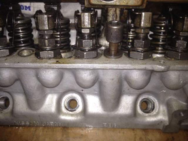

Picked up an F54/P79 L28e longblock from a junkyard recently, sold to me as a "good running motor", and naturally I found this: Using a long machinists square and feeler gauges, the head appears to be warped, between 4-6 thousands of an inch in various spots depending on where the measurement is being taken. At a minimum, the head needs to be resurfaced. The block, however, appears to be spot on. The rod bearings are all in spec, the journal on the crank measures out perfect, as does the cylinder bore. Compression test showed 150-160 across all 6 cylinders, and a leakdown came back with 7%-14%. I've got this lying on the shelf: It's an E88 with the A grind cam (longer duration, lift on intake) that's been hottanked, resurfaced, with L28 intake valves. Measures out to far better than spec with the same square and feeler gauges. I'm extremely tempted to put the P79 on the shelf, and bolt the E88 up to the F54. I've got a 1.25mm felpro headgasket ready to go and believe that'll give me roughly a 10.4:1 compression ratio. The intended use for the car is heavy autox, light track, light street. It'll see _maybe_ 1-2k miles / year, of which 30-40% will be wide open. I'm running dual weber dgvs with plenty of spare jets lying around, a 6-2 square port header (which also better matches the E88 head) and dual exhaust. I'm also running an optical dist with a 12v coil and crane xr700 electronic ignition (used to be alison before they were bought out). All I can find to discourage me are the threads concerning detonation issues. I have zero problems running 93 all day long, and given the low mileage and intended usage of the car, I don't necessarily have any issue with the idea of running around with cans of octane booster ready for each and every fill-up. However, that being said... there isn't a lot of point to all that compression if I have to dial the timing way way back to prevent detonation. What do you guys think? Worth the risk to go E88/F54, or should I go the "safe" route and send the P79 head off to the machine shop?
