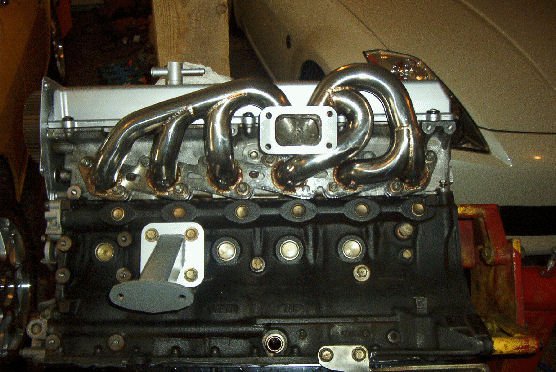

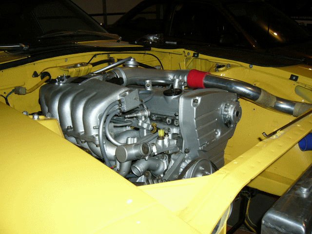

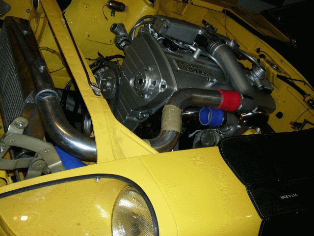

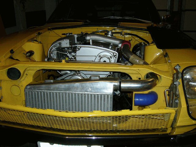

  19. Im cheap too, so thats what Ill do! As far as what Im trying to do is clean up the harness and get the alternator wired in. I pretty sure I understand now. I have removed all the wiring for the regulator and will wire in the alternator as it was in the Skyline. THen I want to remove the amp gauge and replace it with a voltmeter...I think it will be more helpful as far as the info it gives. One thing Im not sure what to do with is the wires that went to the ignition resistor and coil. Can I use these for anything? First things first...I want to be able to turn over the engine and see if the alternator is doing anything. After that I will be hooking up the RB engine harness. Little clue were to start with that one!!! I guess I need to send power to the ECU. It also looks like there are a few accessory harnesses that I may want to remove but Im not sure yet what is what.....and perhaps a few thing to add...fuses! I created this spreadsheet ......it should help.... ( how do I post an excel file?).....Its a pin placement vs wire colour chart.
  20. Thanx..took me long enough...now I gotta get it running for the summer!
  21. PICS...another try...hope its better.
  22. At last...my RB20DET is siting in my 71Z...check it out below! HOW SWEET it is! Now Im trying to hook up the electrical. Please bare with me as Im electricaly challenged and I will probably ask some basic questions. First...Am I correct in saying that the alternator and starter have nothing to do with the ECU harness and that these can be wired directly into the 240 harness... Starter...straight forward as near as I can tell.....just wire up like the the original. Correct? Alternator: The stock 240 alternator is externaly regulated while the RB20 is internal... The RB has a: - heavy black wire that goes to the battery to which the underhood fuse box originally attaches to. This the battery charging wire...correct?? - thick white/blue wire -plug with a smaller white/blue and a white/red wire -ground wire The Z has a : -Thick white/red -plug with a yellow and a white/black wire -ground The charge wire...incorporate it into the harness The ground is self explanitory. Connector...run the yellow wire to the charge wire..? ....run the white/black to a volt meter...confirms if the alt. is charging...(I will replace the 240Z amp gauge for a 280Z volt gauge) The thick white/blue and white/red interchange THe oil pressure sensor on the RB is two wire...the z has a one wire. What can I do to make this work. Just change to a one wire sensore or can I make the the two wire sensor iwork in the z harness.? thanx jerry
