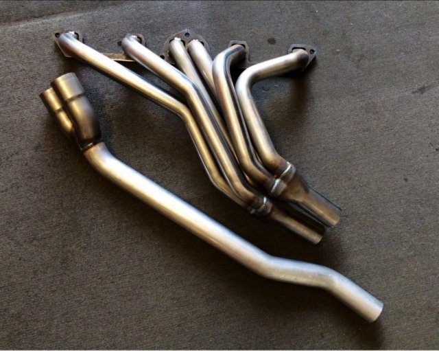

next time around, I'm going to use this type of header- 6-2-1. During the dyno tuning, I painted the exhaust to get a heat signature. The 6-1 is probably not the most efficient style of header. I see maybe 5-8 more hp.tq. with the 6-2-1. I often see people using 3" exhaust on these motors. Is that just for peak HP? I don't see how that would make tq. at this displacement.
BTW Folks, I found my dyno chart from many years back.... 184hp and 133 ft. lbs. tq. This time- 231hp and 211 ft. lbs. Great gain for pump fuel...... I've been on engine dynos as well and I would still prefer a turbo engine if it was all about power. It's not that expensive for turbo conversions and power is at your finger tips... My Z is more of a restomodern approach which TB injection is very unique..... I have a heatshield for the exhaust header, but looking at the way that it's been done with a plate of aluminum, I'm optining to design something else out of much better materials and has proven thermal properties......

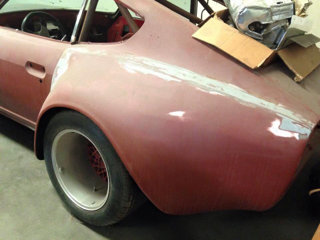

I will be on week 4 starting Monday. The was 3 weeks more than I wanted- unrealistic, I know. For any car build, you can bet that the budget will be 4 times more and 4 times longer. I did my best and it happened to me. I generally don't go to my warehouse often, but since this Z work began, it's been every other day hunting for parts.... Big Red sits in a corner. I've only drawn up a build list to restore it, but I think my initial goal would just be power and power alone; I'd like to see what we know now compared to 20 years ago. I have the new turbo already, ecu harness and cable, software. I think I could reassemble the engine components within 2 days and one day to flush out the fuel tank. I would definitely order as many parts at one time, so that there aren't days in between waiting on parts that I would consider simple- brake master cylinder.... I found a body that's located in Japan and it's not too expensive, respectively, I just don't want things sitting around where I always lose them and have to buy again- I'm a bit famous for that. Thoughts?

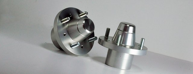

passenger side hub has some free-play, not bad, but it's definitely showing its age.... will replace with billet set an pack new bearings with race grease... now what else.....

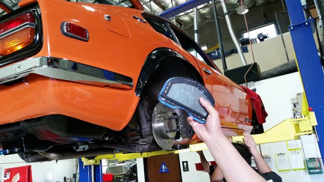

need to figure out the speedo and tach...... I like the classic look of the gauges and don't want to muck this up too much..... i could easily make a mount and install an AIM stack display, but that would just look funny....

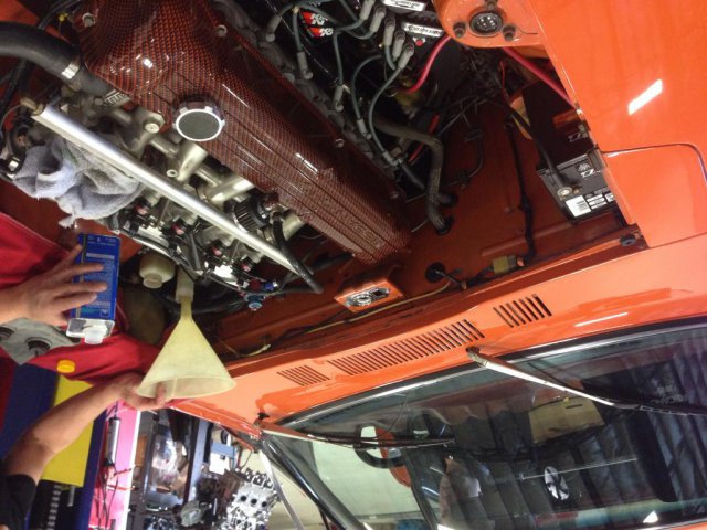

close--- master cylinder is bad and front tires were my fault. spending the rest of the day checking the pinout to the fan and tach. just changed out main heater hose and swapping out dyno oil for fresh fluids...... new master cylinder should arrive on Monday, tires tuesday and whatever else I can't remember.... We do have to rewire the brake lights, since I have the Euro lenses......

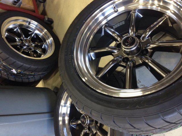

Ordering new size front tires!!!! Damn!!!

I bought the wrong tires... 245/45/17. Instead of 40. I'll give it a try. The tire is a little taller than the rear, so the take is off.... No big deal, I can just buy the correct ones should this not fit properly .....

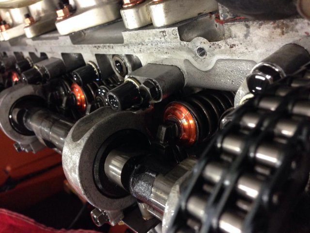

Replaced Valve Cover gasket.... Not sure if I have any time tomorrow..... Too much work with race season beginning...
