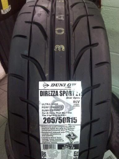

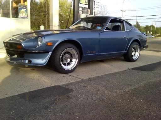

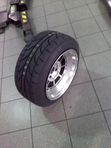

280Dan Posted May 6, 2012 Share Posted May 6, 2012 (edited) I just installed a set of the 15x9 0 offset Shakotan's and I love them. I went with a set of 205/50 Dunlop Direzza Sport Star Specs... Just needs a drop and fender flares IMO. *I'm on Tokico shocks and springs and they won't fit without spacers however. I used the only spacers Pepboys sold and I'm not sure what size they are but I had to slightly hammer in the outside edge of the spring perches to get the tires to clear. Edited May 6, 2012 by 280Dan Quote Link to comment Share on other sites More sharing options...
lorenzo Posted May 6, 2012 Share Posted May 6, 2012 Looks to me that it could be lowered an inch or two, you could have also went with a higher profile tire which would have filled more of the wheel well. I think if you lowered it more you would find that flares are not required. I would like to see these wheels with the center painted silver, like they were on the Mangusta, the spokes look a little skinny because of the black paint. Quote Link to comment Share on other sites More sharing options...
yhlz Posted May 6, 2012 Share Posted May 6, 2012 Looking good 280Dan! you wont need flares but if you go that route, make sure you get spacers to offset for the flares. Quote Link to comment Share on other sites More sharing options...

280Dan Posted May 7, 2012 Share Posted May 7, 2012 Thanks. I know I don't need flares but I want them, and yeah I know I'll need bigger spacers too. Quote Link to comment Share on other sites More sharing options...
