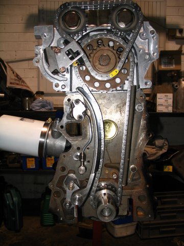

PMC raceengines Posted June 24, 2012 Author Share Posted June 24, 2012 (edited) Just playing with the idear of chain drive like the L4S we do just to make it diffrent Edited June 24, 2012 by PMC raceengines Quote Link to comment Share on other sites More sharing options...
Z Greek Posted June 24, 2012 Share Posted June 24, 2012 Just playing with the idear of chain drive like the L4S we do just to make it diffrent Wow, Peter, that is some impressive engineering. Quote Link to comment Share on other sites More sharing options...
Mack Posted June 24, 2012 Share Posted June 24, 2012 Is that a KA head on an L4? Did you end up finding the 18 tooth gear that almost fits on the crank snout or did you make your own? Quote Link to comment Share on other sites More sharing options...
ZIPPY Posted June 24, 2012 Share Posted June 24, 2012 tI like that tensioner design alot. I have been toying wiht the idea of making a roller tensioner similar to the kameari design. What did you construct the slack side back out of? Quote Link to comment Share on other sites More sharing options...
RB26powered74zcar Posted June 24, 2012 Share Posted June 24, 2012 Awesome workmanship!! What head/block combo is that? Quote Link to comment Share on other sites More sharing options...
PMC raceengines Posted June 24, 2012 Author Share Posted June 24, 2012 Hi all this one is L18 BUT ITS 2.3L with a KA24 head We make the crank and crank gear , the tenchener is a L28 type that we feed oil to the slack side is SR 20 , we drill and tap the block to fit it, there is lots of work in there ... This engine makes 300hp on the engine dyno and we now make a 2.6L from a z24 block that is a real torque monster Quote Link to comment Share on other sites More sharing options...
