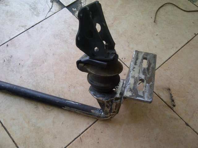

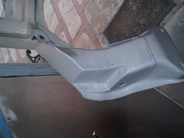

docaam Posted June 10, 2013 Author Share Posted June 10, 2013 Working on the engine mounts, cross member had to be dissected quiet a lot, will reinforce it with steel sheets where the line is, which will be done once new forester steering rack reaches here on Thursday. Might need to relocate the oil filter as well. Took a rollcage style pipe 1.5" will use it as new cross member welded to two plates which will lie on stock chassis rails, as we can weld anything on the chassis so will drill the rails and install steel tube to hold the bolts might put less stress on the rails. Mounts will be using stock for VQ35DE from 350Z, so far spacing seems tight but manageable Main issue which was worried about was exhaust manifold with the turbo so that fits without touching the chassis rails but still engine is more on right side then left so some small alternation might be needed. There is same plate with two holes and some provision is left to move engine front and back incase its needed For gear shifter might need some cutting as well where the red circle is marked but it will be done in the end. Quote Link to comment Share on other sites More sharing options...

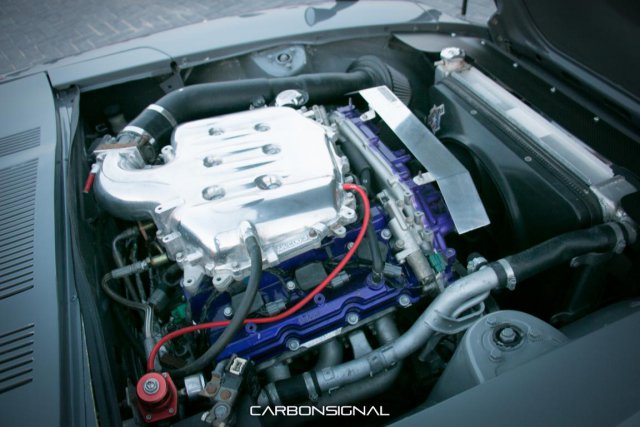

Pharaohabq Posted June 10, 2013 Share Posted June 10, 2013 Wow those Turbos are a squeeze in there. I wonder if you can swap left/right exhaust manifolds to move the turbos forward a little to clear your brake MC a little more. It'll be tight either way. I can you you did have to cut quite a big from the steering crossmember.. If you box it in in front and under the Rack you should be fine. Did you look at the engine mounts in the link I sent you a while ago? They're pretty good and a lot more minimal than using anything that looks similar to the stock mounts (350z type) That setup uses L angle iron to allow the mount to be slid forward and back so you can get just the right locations. I can send the link again if you need. Yeah, That shifter, even with the shifter shortened as far as I could, I still had to cut about 2" back on the shifter hole to make mine fit. You'll be fine I think. maybe 1", just enhour to get into gear. You may have to notch the right side to so you can get it into reverse. but that'll all come later. Phar Quote Link to comment Share on other sites More sharing options...
docaam Posted June 11, 2013 Author Share Posted June 11, 2013 On 6/10/2013 at 8:47 PM, Pharaohabq said: Wow those Turbos are a squeeze in there. I wonder if you can swap left/right exhaust manifolds to move the turbos forward a little to clear your brake MC a little more. It'll be tight either way. I can you you did have to cut quite a big from the steering crossmember.. If you box it in in front and under the Rack you should be fine. Did you look at the engine mounts in the link I sent you a while ago? They're pretty good and a lot more minimal than using anything that looks similar to the stock mounts (350z type) That setup uses L angle iron to allow the mount to be slid forward and back so you can get just the right locations. I can send the link again if you need. Yeah, That shifter, even with the shifter shortened as far as I could, I still had to cut about 2" back on the shifter hole to make mine fit. You'll be fine I think. maybe 1", just enhour to get into gear. You may have to notch the right side to so you can get it into reverse. but that'll all come later. Phar I can move the turbo or add another lol as its just 100$, but dont want to route turbo lines, there would be some alteration to down pipe part and I might put some spacer to move the turbo a bit up, but all after mounts are done. You didnt send me any link but just some name, please so do if you can. Only reason using 350Z mounts is for future incase wants some good or solid mounts then they will be bolt on. Quote Link to comment Share on other sites More sharing options...

docaam Posted June 17, 2013 Author Share Posted June 17, 2013 On 6/17/2013 at 2:21 PM, Pharaohabq said: Here's the Link to MikeyM's VQ mounts: It's in the RedZedBuildThread on the V6 forum. http://forums.hybridz.org/topic/106860-red-zed-build-thread/ Thanks man, I think I saw those but mine was kind of done when I passed by yesterday one picture attached will post later more, and the part which you have shown Im using stock one along with 350Z mounts, the problem here is if there are any visible of welds in chassis or mounts they don't renew the yearly registration so using stock engine mount was mainly because of this hassle and cant weld the cross member for same reason. I will try to follow the gear mounting as per MikeyM's mount seems legit Quote Link to comment Share on other sites More sharing options...
Pharaohabq Posted June 17, 2013 Share Posted June 17, 2013 MikeyM's mounts aside. I see in your pictures what you've been doing. You've cut out a lot of your Crossmember, Maybe more than really needed, but no matter, with some good bracing and boxing in, that crossmember should work out well. Here's a picture of mine from my HR thread: You can see there the little cut I did for my oil filter. I may end up putting an adapter and relocating the filter along with adding an oil cooler. Currently though I have about 2cm of clearance around the filter with that cut. You can see I've boxed in and added a good amount of material to the cross member. Unfortunately you can't move that crossmember without messing with the steering/suspension geometry. Now that AC pump really looks like it'll be in the way. I'm note sure how you're going to get around that. I'm going to try making a plate that will move the AC Pump up along that side though on the VQ35, the Water line from the radiator is about 10cm above the pump. Another idea is to try to swap the AC and PS pumps, moving the AC pump out farther to the left and the PS pump up and hopefully the steering will clear after adding Ujoints. Making the brackets will be a pain, but I gotta have AC too, Though it gets hot here in New Mexico, I know its a lot hotter in Dubai. When I get to this part, I'll be certain to show you what I do. Though I think you're ahead of me since I still am working on getting my Z painted. Phar Quote Link to comment Share on other sites More sharing options...
Pharaohabq Posted June 17, 2013 Share Posted June 17, 2013 I'm not sure I understand. You said you're not allowed to have visible Welds in your mounts? Does that mean you can weld it, but that the welds like you've done in your engine mounts have to be cleaned up and sanded smooth? That seems pretty strict, but I guess they're trying to keep things safe and prevent people from just throwing things together. I was going to use the Stock rubber isolators myself, but they are so tall, I didn't want to add to the trouble of getting around the AC pump for the steering shaft. I'm using something similar to Mikey's mounts, but instead of the stock mount, like you've got, I'm using the stock engine bracket, Ford Bronco rubber isolators and the under mount almost the same as Mikey's/McKinney's mount. Of course I've built mine myself as well. Quote Link to comment Share on other sites More sharing options...
docaam Posted June 27, 2013 Author Share Posted June 27, 2013 On 6/17/2013 at 3:41 PM, Pharaohabq said: I'm not sure I understand. You said you're not allowed to have visible Welds in your mounts? Does that mean you can weld it, but that the welds like you've done in your engine mounts have to be cleaned up and sanded smooth? That seems pretty strict, but I guess they're trying to keep things safe and prevent people from just throwing things together. I was going to use the Stock rubber isolators myself, but they are so tall, I didn't want to add to the trouble of getting around the AC pump for the steering shaft. I'm using something similar to Mikey's mounts, but instead of the stock mount, like you've got, I'm using the stock engine bracket, Ford Bronco rubber isolators and the under mount almost the same as Mikey's/McKinney's mount. Of course I've built mine myself as well. Yeah man welds in mounts needed to be smooth I mean really smooth, and NO WELDS on the body at all like some people install bars to support the body or weld the mounts on chassis its not allowed here at all. I did something to the rack and AC thing seems in a better situation now check the post below. Sorry couldn't post updates but there has been some progress but installing this engine sure is difficult We (myself and my mechanic) managed to get a custom cross member done for the engine now its in final shape and been tested already, with stock 350Z mounts. With mounts on Installed the covers to see some space and test the mounts Drilled holes as will keep screws to hold the mount to avoid any registration issues AC compressor blocking stock steering rack Turbo might touch/melt the steering coupler but it will be removed with new rack Height without upper intake manifold seems ok New Steering cross member, clamps to hold the suby steering is not not finalized will use stock rubber bushes. Its basically will move the rack almost half an inch forward but gives good space for crankcase So with suby steering at least keeping AC compressor with a VQ engine seems to be solved there is around 3/4th of an inch gap and can be moved futher with adding another joint. Height might be an issue need some shaving of intake manifold Once steering rod is done will remove both cross members get those properly welded then grinding some epoxy primer and get it powder coated moving to exhaust manifold and fitting other parts. Quote Link to comment Share on other sites More sharing options...
