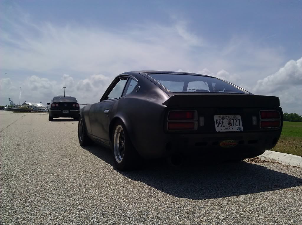

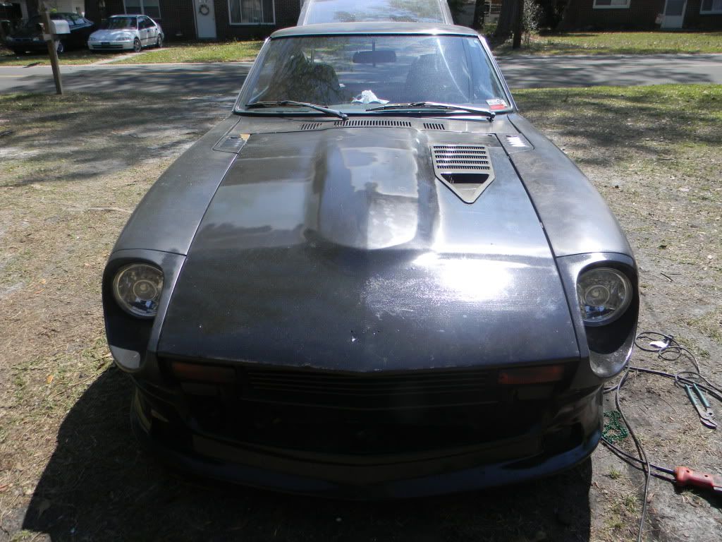

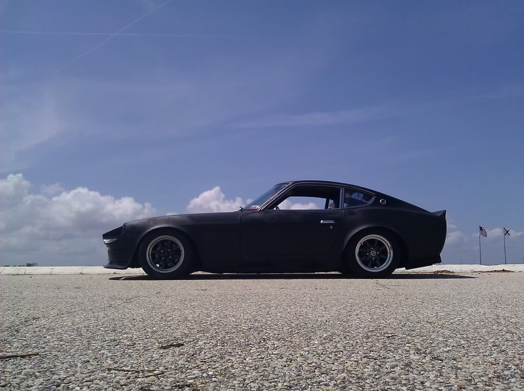

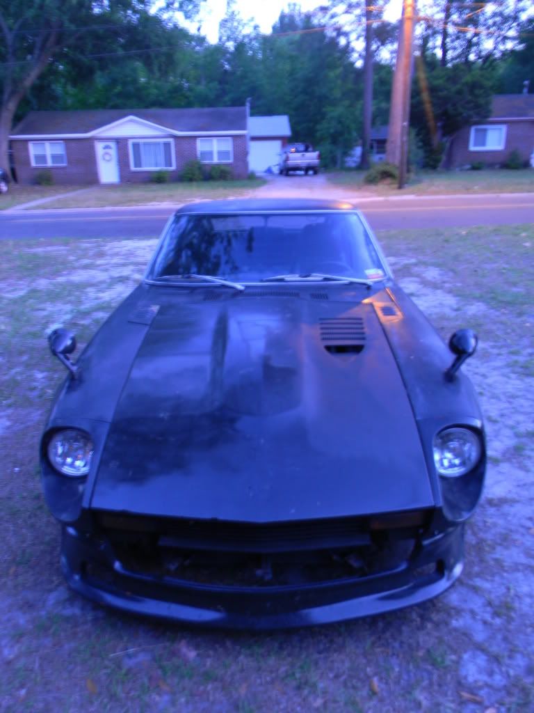

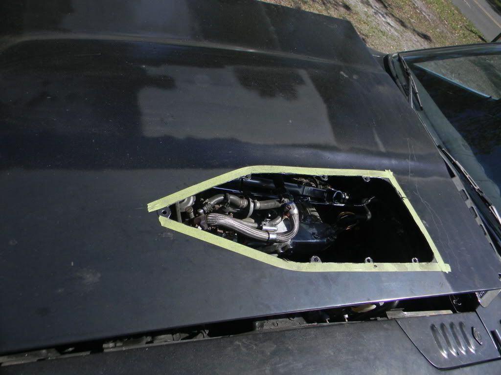

richracing Posted February 17, 2012 Share Posted February 17, 2012 This is my first s30, bought it January 2011 from a guy in Atlanta, GA for $3500. Since then, I've been working on it pretty steady, taking care of the bodywork and paint and getting the ol L28 to run properly with the aftermarket cam and stock ecu . cut springs... ZX hood vent and fender mirrors... Quote Link to comment Share on other sites More sharing options...

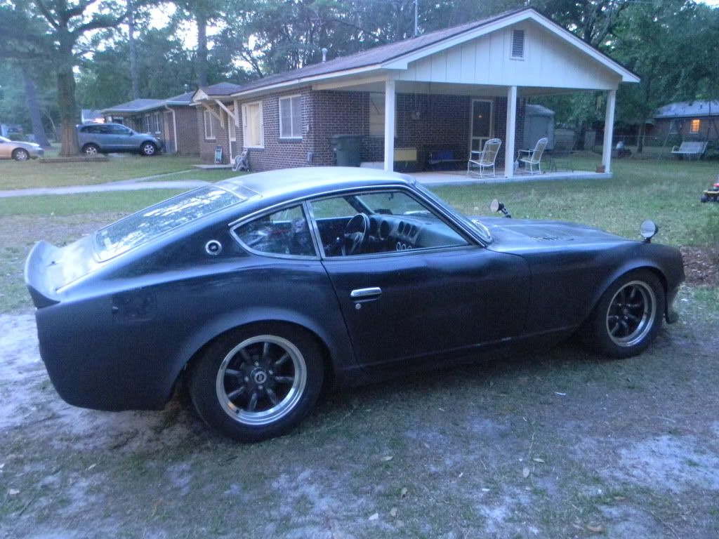

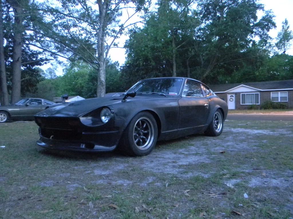

richracing Posted February 17, 2012 Author Share Posted February 17, 2012 (edited) some nice pics I took while home in Mobile, AL... Edited February 17, 2012 by richracing Quote Link to comment Share on other sites More sharing options...

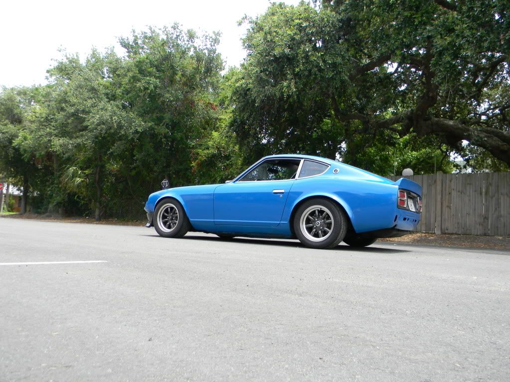

richracing Posted February 17, 2012 Author Share Posted February 17, 2012 time for some PAINT! Laguna Seca blue... Quote Link to comment Share on other sites More sharing options...

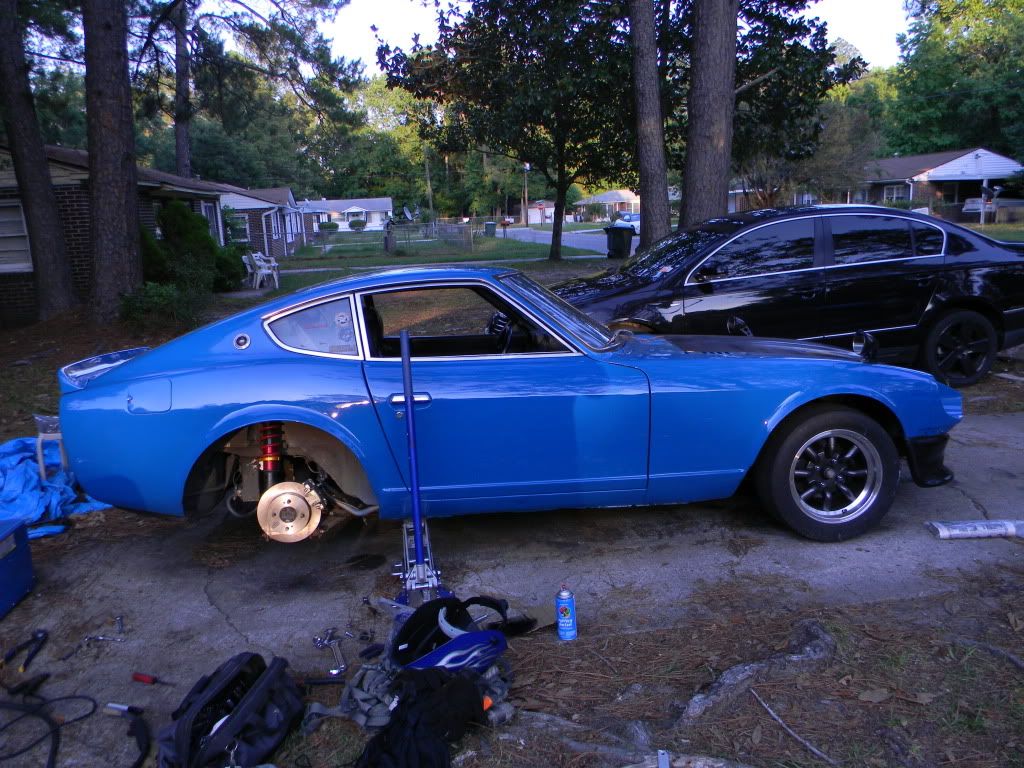

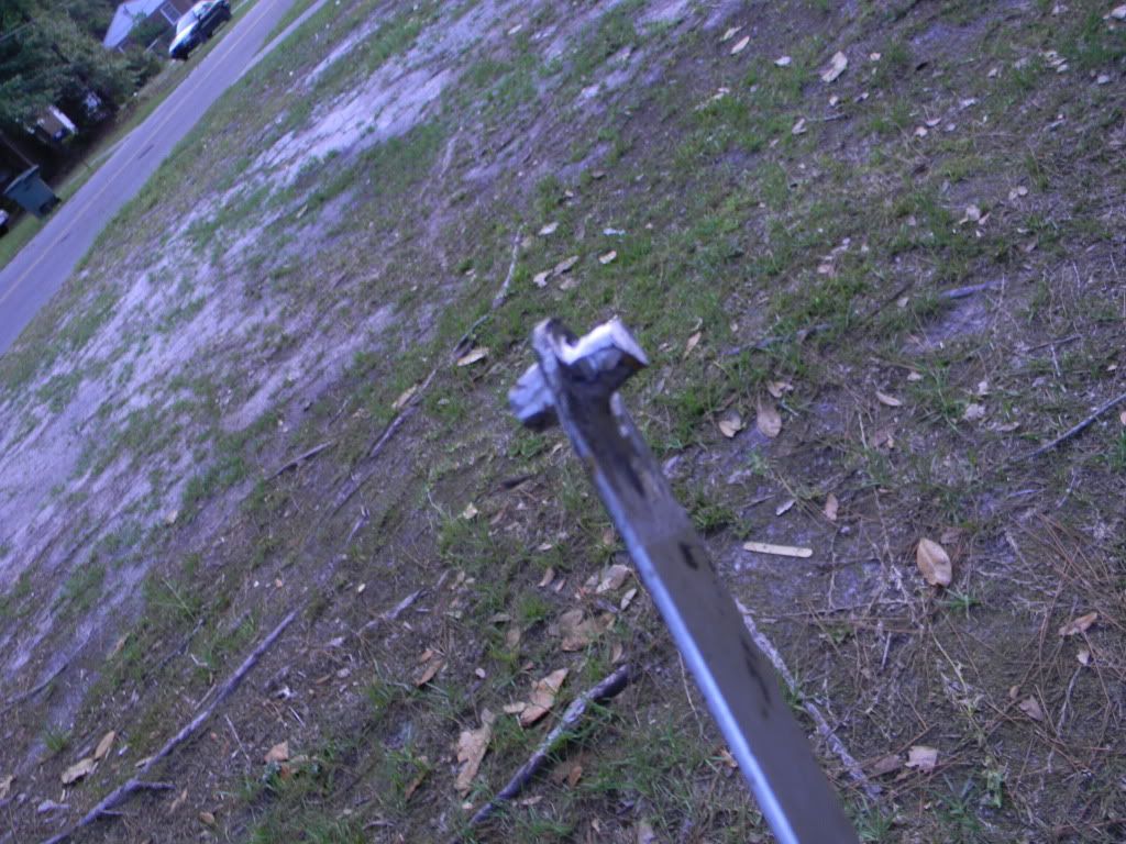

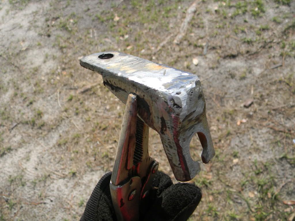

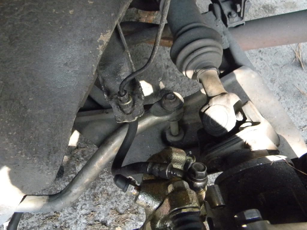

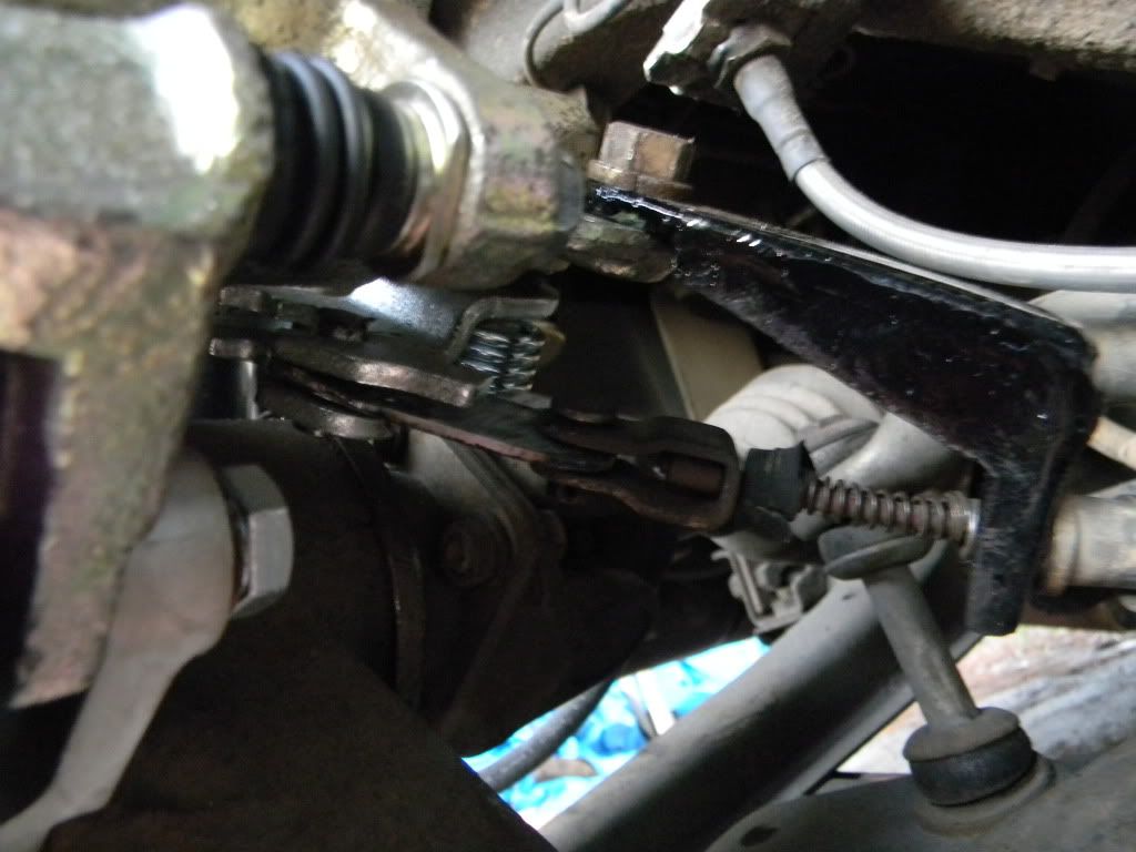

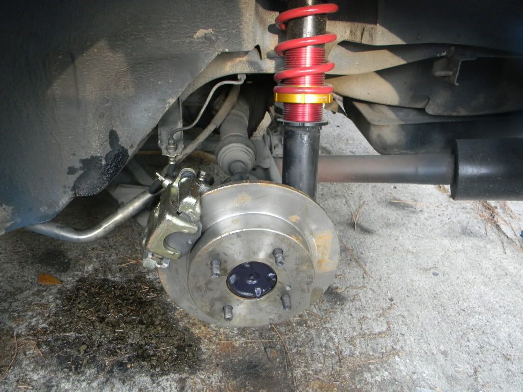

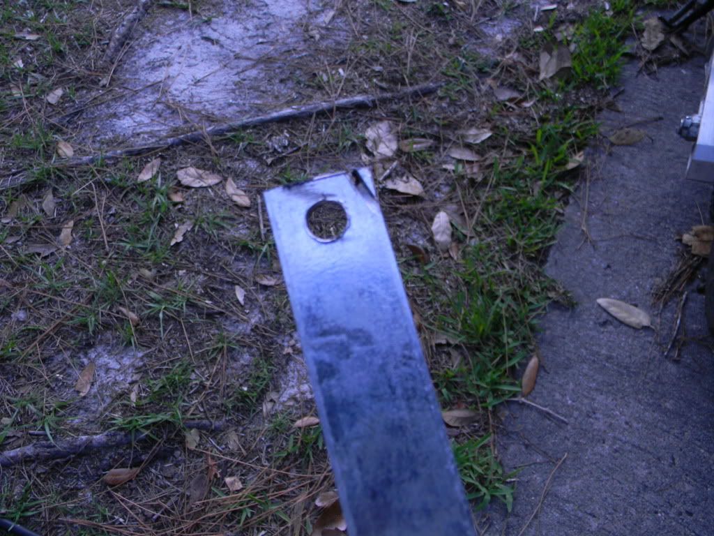

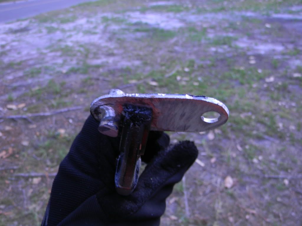

richracing Posted February 17, 2012 Author Share Posted February 17, 2012 Ground Control coilovers and rear disc conversion... '92 accord brake hose fits perfect... fabbing up the parking brake cable bracket... Quote Link to comment Share on other sites More sharing options...
richracing Posted February 17, 2012 Author Share Posted February 17, 2012 a little fun at the Auto X before I ship to Korea... Quote Link to comment Share on other sites More sharing options...

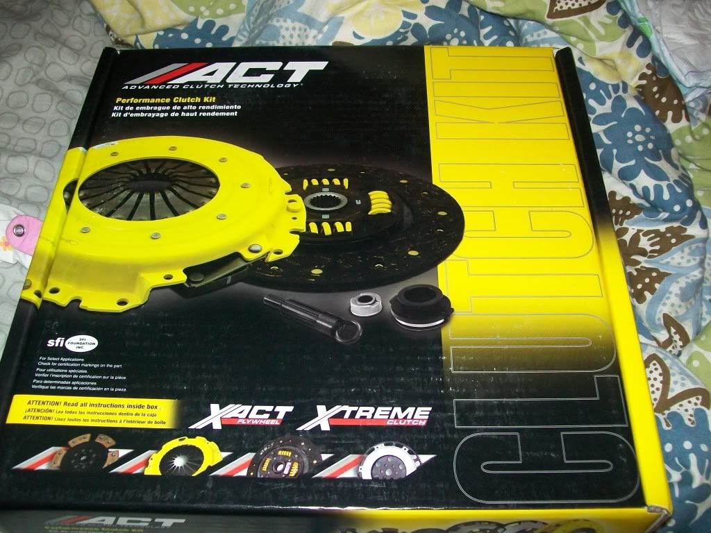

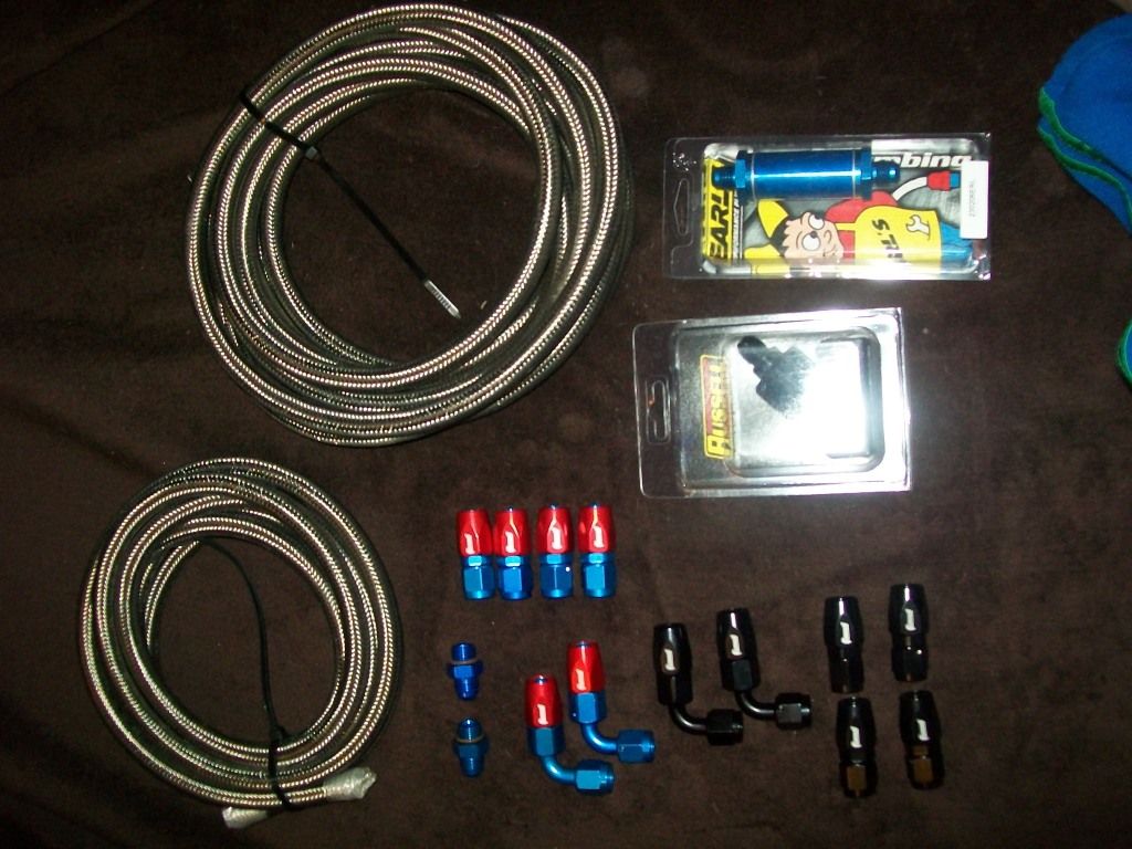

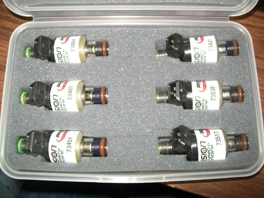

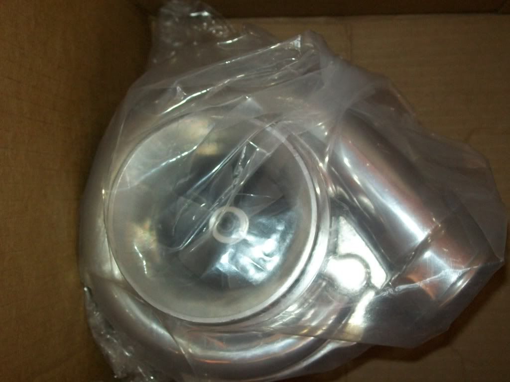

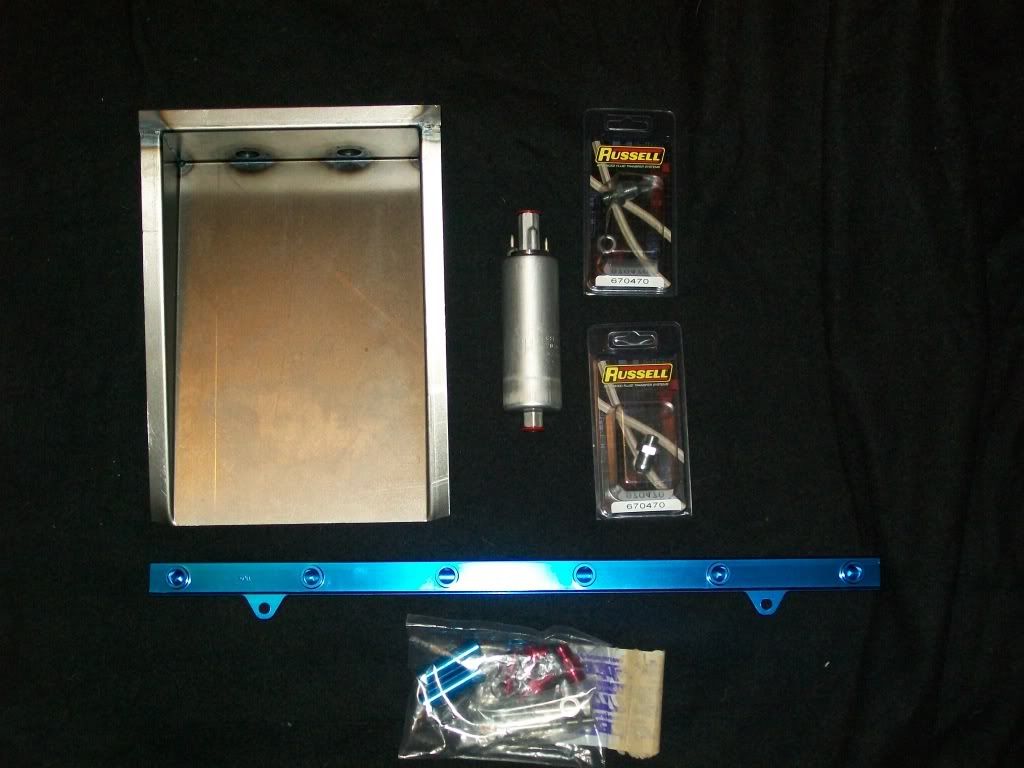

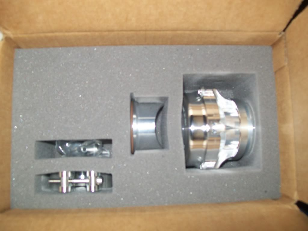

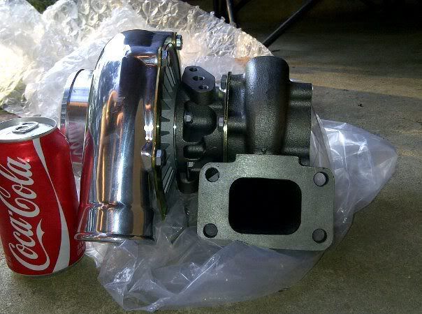

richracing Posted February 17, 2012 Author Share Posted February 17, 2012 Now the real fun begins! I am currently in Korea and in the process of ordering everything I will need for the build. RB25, Mckinney mounts, ebay turbo mani, and Freddy intake mani have already been purchased but don't have any pics of them... Besides that, here is what I've collected so far... ACT clutch T04z t67 turbo bought from used turbos.net Precision 40mm WG Tial BOV Precision 780cc injectors Greddy fuel rail, fuel sump, walbro 255 more fuel parts... Quote Link to comment Share on other sites More sharing options...

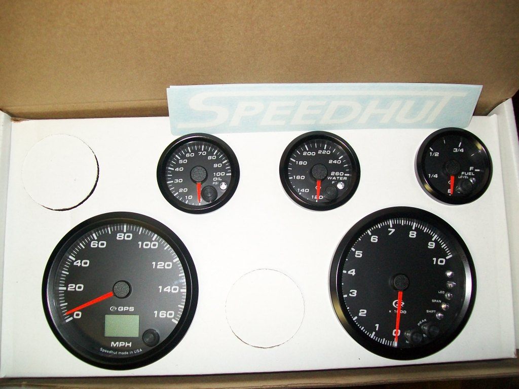

richracing Posted February 25, 2012 Author Share Posted February 25, 2012 Speedhut gauges! still lacking boost psi, egt, and wideband afr... Quote Link to comment Share on other sites More sharing options...

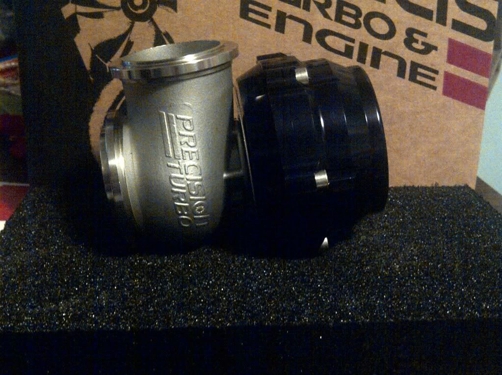

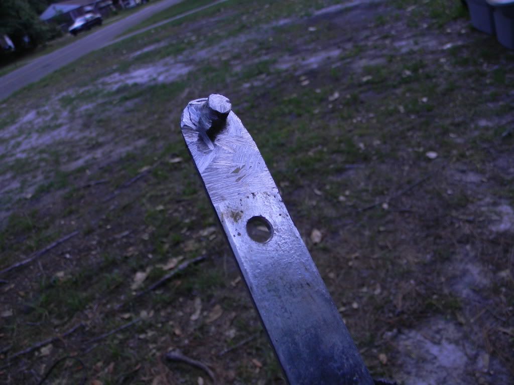

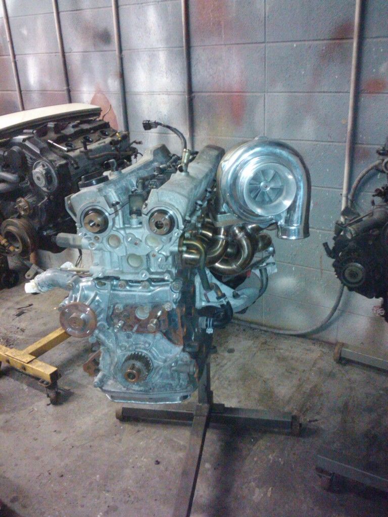

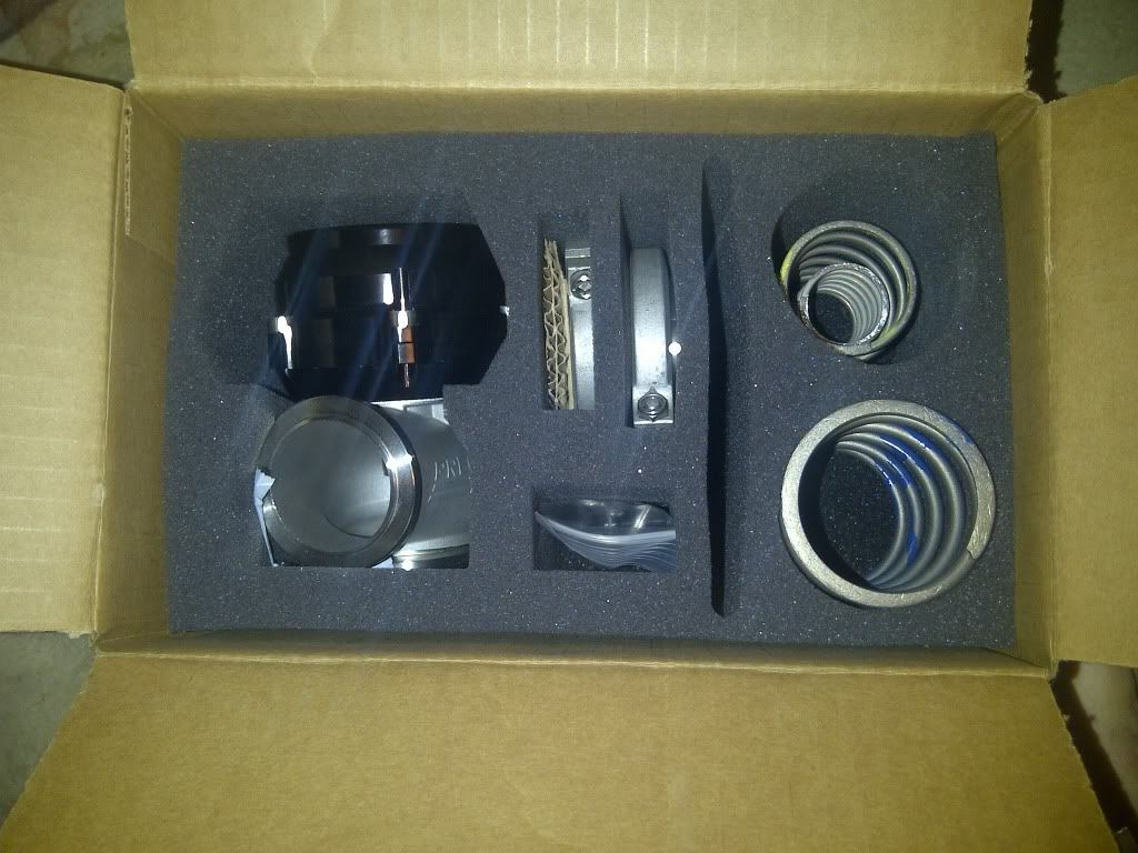

richracing Posted March 10, 2012 Author Share Posted March 10, 2012 (edited) I welded the vband on for the 44mm WG earlier today... Mocked up the intake mani, fuel rail, and injectors... Edited March 10, 2012 by richracing Quote Link to comment Share on other sites More sharing options...

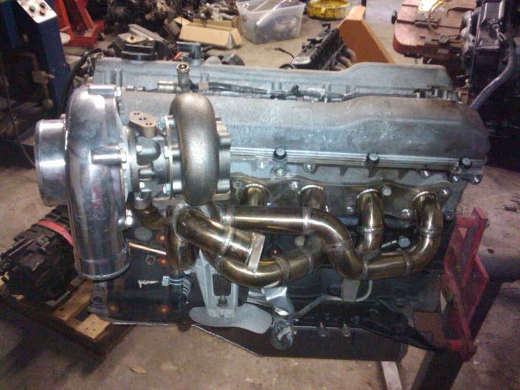

richracing Posted March 11, 2012 Author Share Posted March 11, 2012 I figure I'll post a lil review on the CX turbo manifold that I'm using... Although the runner design obviously isn't the best, not being equal length and what not, it is made of thicker steel than I've ever seen on a CX manifold. and the welds look alot cleaner inside and out. Overall, I think it will hold up just fine, as long as it allows the t67 to spool up quick enough. Quote Link to comment Share on other sites More sharing options...

richracing Posted May 5, 2012 Author Share Posted May 5, 2012 It's actually only a .63 ar, so I don't think it will be too laggy. I think it's just the huge compressor housing that makes it look that big. I am excited to see how it performs for sure! Quote Link to comment Share on other sites More sharing options...

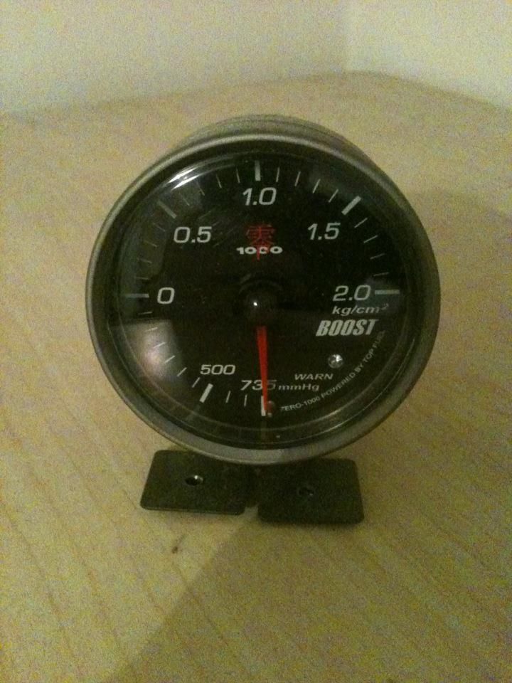

richracing Posted July 24, 2012 Author Share Posted July 24, 2012 I just picked up this used Top Fuel boost gauge... Other than that, no real updates. Quote Link to comment Share on other sites More sharing options...
