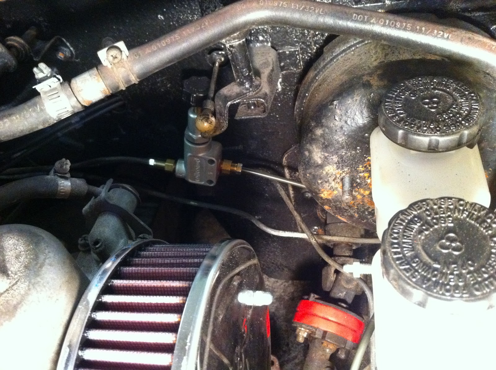

That seems unnecessary. I would just go to NAPA and buy two male-male brake fitting unions. Simplifies the system, and cleans up the engine bay. I used one when I installed my prop valve.
See it chilling there below the valve?
Oh yeah, looks simple and great. The prop valve on a 240z (that's what I got experience with) is under the axles in the back of the car. Your solution looks much simpler. It was a PITA putting the prop valve INSIDE the cockpit, and in all honesty, once I get it set, I probably won't adjust it, so your solution looks great.
Since we don't know what year the OP's car is, I would not recommend to them to remove the guts of the stock prop valve. Doing this with the early S30 (up to '72) means that you are only affecting the rear brakes (though changing overall balance). Gutting a later prop valve, ('73+) means that the front and rear brake systems are no longer independent, and if there is a brake line failure at either end of the car, will lose brake fluid from both reservoirs.
