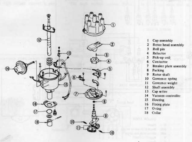

JCan Posted February 18, 2015 Share Posted February 18, 2015 (edited) Hey guys. Do you mind if I restart this thread? We have a 280z motor running a 280z distributor and electronic ignition. We are also seeing the timing retard 15 degrees. The distributor was rebuilt prior to installation, berings were replaced, advance curve was modified, it was designed to be run with a vacuum advance connected directly to the intake manifold. We are also experiencing a static change. I noticed that with the car off, I can move rotate the distributor shaft with my hand to expand the centrifugal advance but when I return the rotor it stops pre-maturely, I can force it to go back to zero. Are you suggesting that this slop is caused by the distributor drive shaft? Who knew! Over the weekend, I plan to remove the distributor and try to see if the gear has slop. If not then I guess I should focus on the distributor. Any comments are welcomed. Jim Edited February 18, 2015 by JCan Quote Link to comment Share on other sites More sharing options...
NewZed Posted February 18, 2015 Share Posted February 18, 2015 We have a 280z motor running a 280z distributor and electronic ignition. We are also seeing the timing retard 15 degrees. it was designed to be run with a vacuum advance connected directly to the intake manifold. We are also experiencing a static change. When does the timing retard? Not really clear what you're describing. And there aren't really any design elements needed to connect directly to intake manifold. Once you open the throttle on ported manifold vacuum, it's connected directly anyway. Connecting to full time vacuum just gives high advance at idle. Ported vacuum gives retarded, more stable, idle timing Quote Link to comment Share on other sites More sharing options...
JCan Posted February 22, 2015 Share Posted February 22, 2015 NewZed. To answer your questions the timing varies, we set it at 15btdc and check it after a day and it reads 0 btdc as an example. we use our vacuum advance more as a switch. when throttle is full open it retards, at idle it is full advance. To describe our problem a bit better. okay. When I pull off the distributor cap and turn the rotor to full advance (clockwise) (stretch the springs) and let go the rotor does not stop at zero, it stops somewhere before zero, For the sake of clarity, i will call this location 15 deg. if I rotate counter clockwise from this 15 degree mark it will move there, but it almost feels lkike the shaft is hitting something very slightly. this could be an issue in the distributor or with the gear, maybe the gear slop in the Z axis is allowing the gear to move, maybe the gear is not attached to the spindle? or maybe I actually have a screw that is hampering the return of the advance. We have not yet pulled the distributor offf to try to rotate the spindle to determine if the problem is with the spindle or the distributor. Once we do, I will comment here. Thanks for your help... Jim Quote Link to comment Share on other sites More sharing options...
NewZed Posted February 22, 2015 Share Posted February 22, 2015 (edited) Pretty easy to pop the reluctor wheel off and remove the breaker plate. Then you can watch the weights and springs as you rotate the advance mechanism. Hold the bottom and twist the top. Something's not right in there. It should move smoothly, weights moving outward away from the shaft, and snap back to where the weights are in by the shaft. It does that over and over when in use, sometimes divots get worn in to the mechanism pieces. Things dry out over time also, along with rusting. Edited February 22, 2015 by NewZed Quote Link to comment Share on other sites More sharing options...
